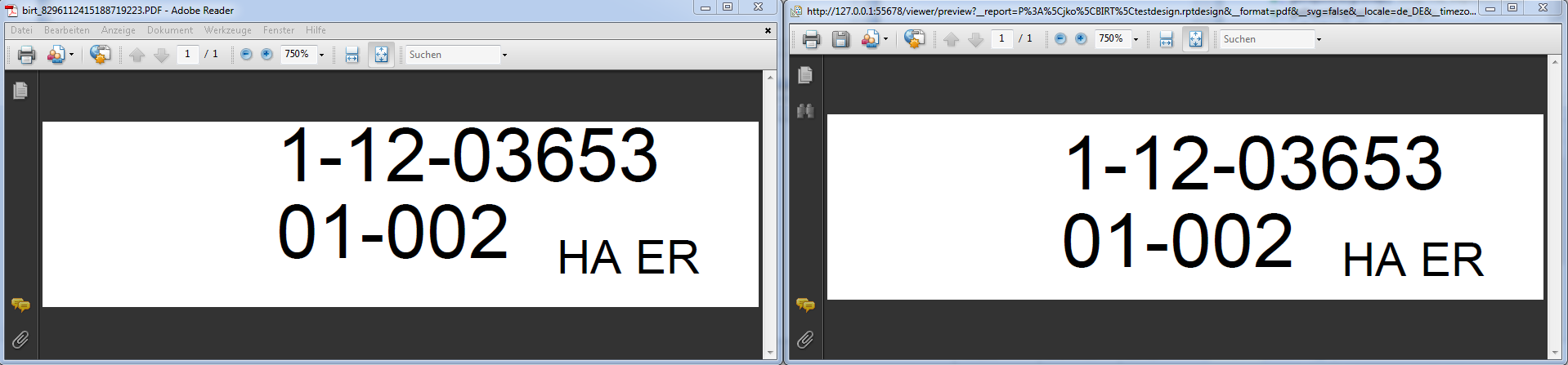

Re: What Render Options does the Report Designer use? [message #831191 is a reply to message #826156] Wed, 28 March 2012 11:35 Go to previous messageGo to next message
Jason,
the problem is that the top margin of the documents is not the same.
See the picture below:
http://xoom.cc/images/7voXP.png
notice the top margin!
The document called Designer.pdf was rendered by the BIRT viewer. The Reporter.pdf with my program. I tried the settings you posted above but they made no difference.
What else than the render options could be wrong here?
Thank you!

Re: What Render Options does the Report Designer use? [message #832504 is a reply to message #832334] Fri, 30 March 2012 04:12 Go to previous messageGo to next message
Jason,
I'm using a run then a render operation. I've also tried run and render just to check it, but the result was the same. In the viewer I render directly to PDF.
I've edited ther report design to not use any data set or barcodes anymore. The result is the same. I've added the report design and new screenshots.
In Sample2.png you can see the output of the new report design. The left picture is the output when running BIRT from my application. The right picture comes from the BIRT Designer.
Thank you!
Re: What Render Options does the Report Designer use? [message #832905 is a reply to message #832504] Fri, 30 March 2012 14:40 Go to previous message
Jan,
Something else is happening here. I just ran your report in the viewer
and using the following code and they both produced the same thing,
which is your pic on the right.
