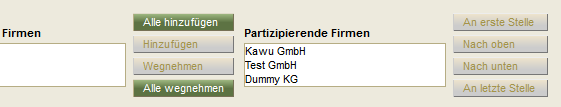

In the client JSF page the field `participatingCompanies` is used like:
<rich:pickList value="#{pqHome.participatingCompanies}"
               var="company"
               converter="#{companyConverter}"
               orderable="true"
               sourceCaption="Available companies"
               targetCaption="Selected companies">
  <f:selectItems value="#{companyManager.externalCompanies}" />
  <rich:column>#{company.name}</rich:column>
</rich:pickList>
Don't be intimidated RichFaces component. The list referencing `#{pqHome.participatingCompanies}` just contains optional (external) companies:
index.php/fa/7564/0/
