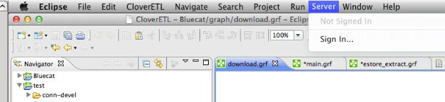

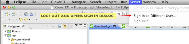

I would need to create global actions that can change state in the time, but don't depend on any editor or view. The actions can be in two states:
index.php/fa/7503/0/
or:
index.php/fa/7504/0/
