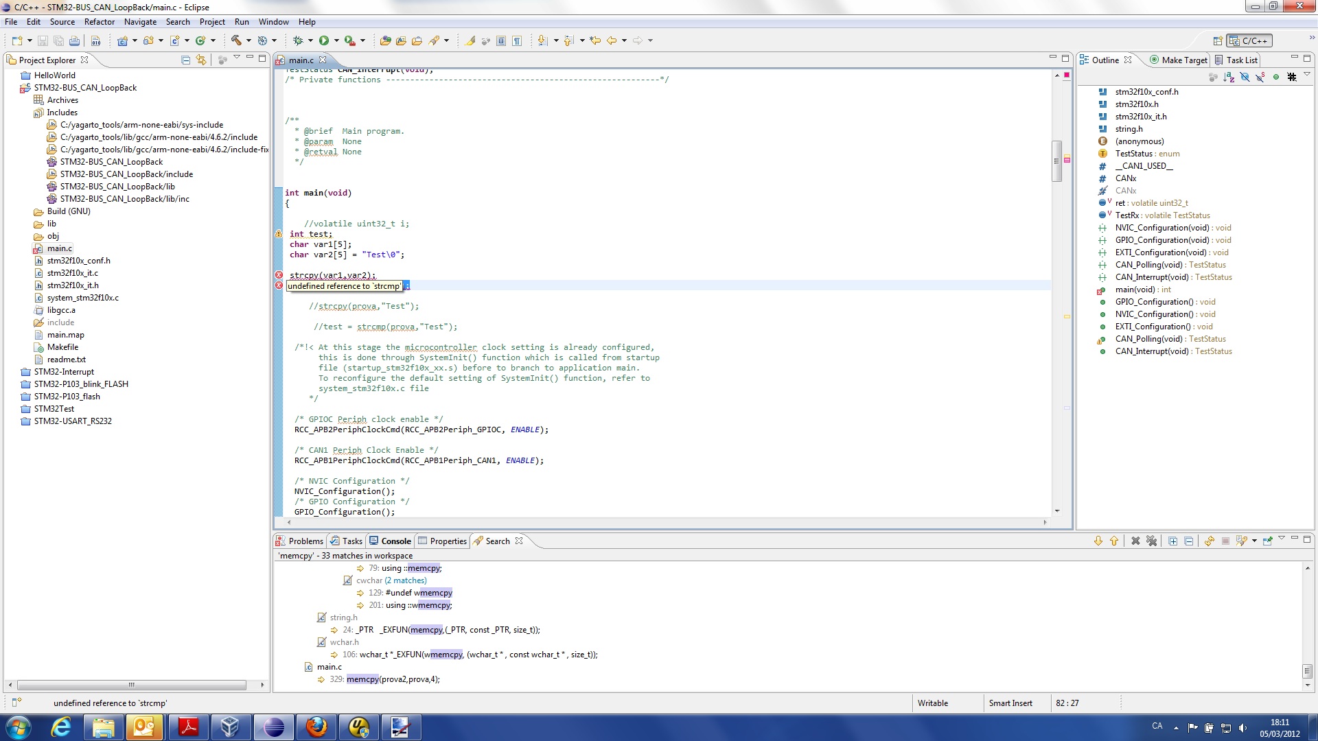

Hi everybody,
maybe it is a stupid question, but I am stuck on it.
I am using an arm-none-eabi toolchain. when I use a function such as strcmp(..); I get un error: undefined reference to strcmp in this case, as you may see from the attached file.
this function is defined in the string.h header file, which I have included in my workspace.index.php/fa/7405/0/
Please advice!
Pauindex.php/fa/7405/0/

Thanks for your prompt reply!
Maybe I did not explain myself. That header file was already in the project although you did not see it, it is defined in the "include" zone, such as:
/* Includes ------------------------------------------------------------------*/
#include "stm32f10x_conf.h"
#include "stm32f10x.h" /* S'hi defineix el tipus de MCU utilitzat*/
#include "stm32f10x_it.h"
#include "string.h"
In the path & Symbols (properties of the project) I have add the path where those header files are in order to use their functions. (Please have a look to the file attached)
Maybe the problem is in my makefile (file attached), where I have not defined where to find that header file. I found this makefile in the web and I adapted to my project.
As I said before any idea will be welcome.
Pau

Yeah, thanks Axel for your reply!
you are absolutly right! Although, apparently the problem is not there! I have done the modifications and I still get the error.
I reckon that my problem is inside the makefile, which while it is linking it does not find these functions.
I am saying this because the output of the makefile:
..linking
arm-none-eabi-ld -g -v -nostartfiles -Map ./main.map -T./lib/stm32_flash.ld -o ./main.out obj/main.o obj/system_stm32f10x.o obj/stm32f10x_gpio.o obj/stm32f10x_rcc.o obj/stm32f10x_it.o obj/stm32f10x_exti.o obj/stm32f10x_pwr.o obj/stm32f10x_dbgmcu.o obj/stm32f10x_usart.o obj/stm32f10x_can.o obj/stm32f10x_iwdg.o obj/misc.o obj/startup_stm32f10x_md.o libgcc.a
GNU ld (GNU Binutils) 2.21
obj/main.o: In function `main':
C:\eclipse\workspace\STM32-BUS_CAN_LoopBack/main.c:85: undefined reference to `strcpy'
C:\eclipse\workspace\STM32-BUS_CAN_LoopBack/main.c:86: undefined reference to `strcmp'
make: *** [main.out] Error 1
Thanks again.
