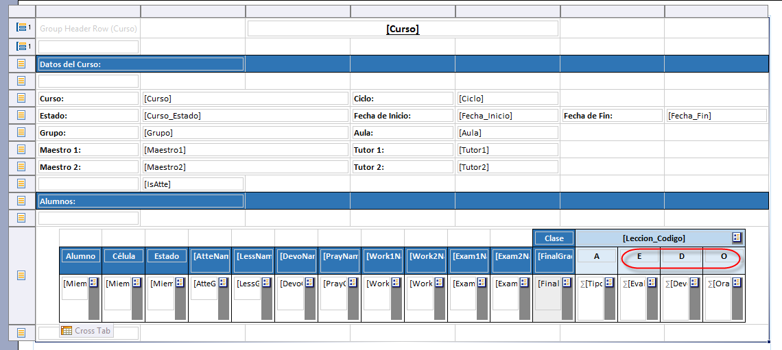

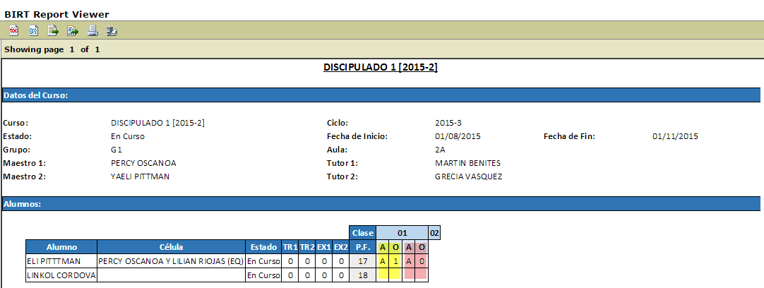

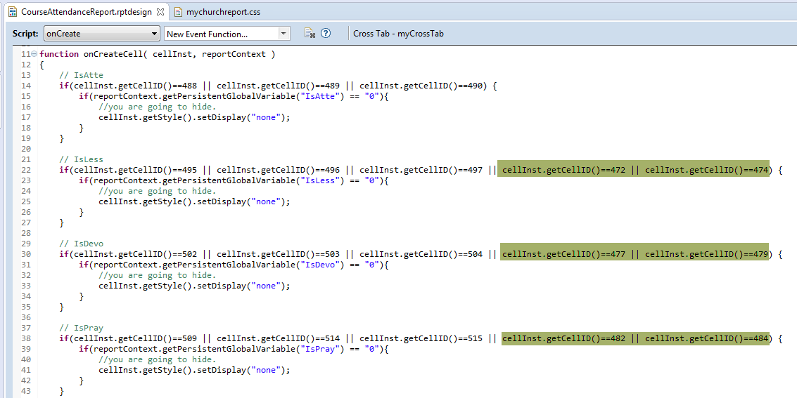

I have hidden dynamically the second level of a cross tab columns, but i have a problem with the colspan of the first level.
I attached images.
Please, i hope your help.
index.php/fa/22835/0/
index.php/fa/22838/0/
index.php/fa/22839/0/

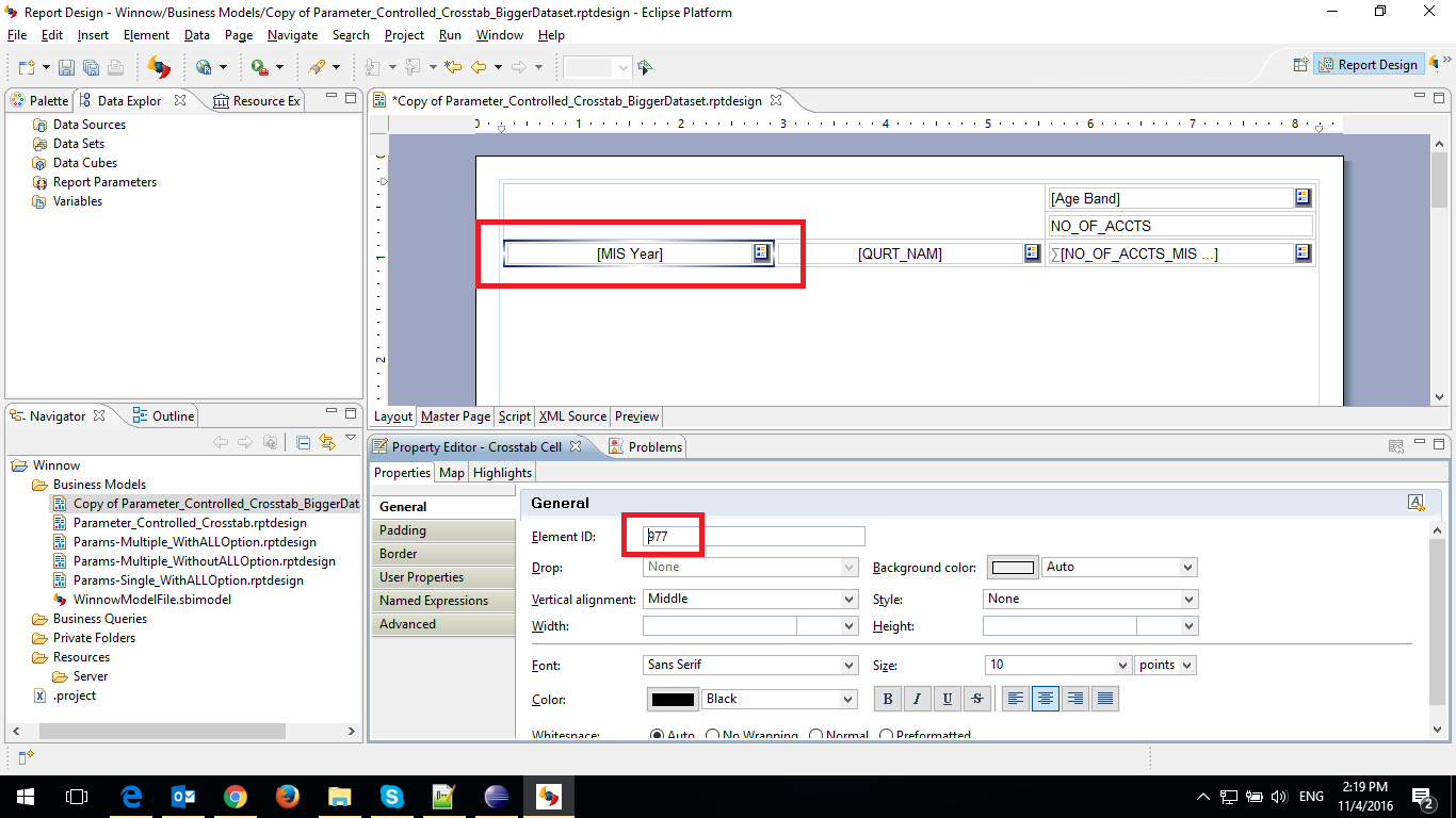

I have a cross-tab (image01). I am trying to hide the Row dimension Year. I am using the following piece of code in the onPrepare script for the Crosstab:
function onPrepareCell( cell, reportContext )
if(cell.getCellID()==977)
cell.getStyle().setDisplay("none");
But this does NOT seem to work. Also, I selected the same crosstab cell and in its Advanced properties, I set Diplay = None. But the cell was still showing.
What am I doing wrong?
Best Regards
