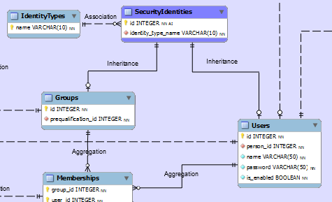

I have the following design:
index.php/fa/7347/0/
As you can see, there's a common base table SecurityIdentities for Users and Groups, which are currently mapped via JOINED inheritance *without using a discriminator*.

Now on some EL expression (doesn't matter) the following SQL query is generated to join Users and SecurityIdentities (which causes a runtime exception BTW):
SELECT
 t0.ID,
 t0.DTYPE,              -- UGH!?
 t0.identity_type_name,
 t1.ID,
 t1.is_enabled,
 t1.NAME,
 t1.PASSWORD,
 t1.person_id
FROM
 SecurityIdentities t0,
 Users t1
WHERE ((t1.ID = t0.ID) AND (t0.DTYPE = ?))
I thought a @DiscriminatorColumn on an inheritance root class is only *optional* for JOINED inheritance. At least Hibernate doesn't need it. (???)
I then found:
http://stackoverflow.com/questions/2063515/why-eclipselink-is-adding-discriminator-column-for-joined-inheritance-strategy
Does EclipseLink really need a discriminator column for JOINED strategy? If so, could it be considered an enhancement to relax the requirement of a discriminator column in a JOINED inheritance? After all, the discriminator column isn't absolutely necessary as entities belonging together could be determined based on the FK columns/values only.
The policy for the code generator could go something like this:
If JOINED inheritance and @DiscriminatorColumn found, use it to join entities and generate the discriminator (as above), otherwise join via FKs and don't generate the DTYPE column in the SQL.
Opinions/comments welcome, especially from the EclipseLink team.
Karsten
