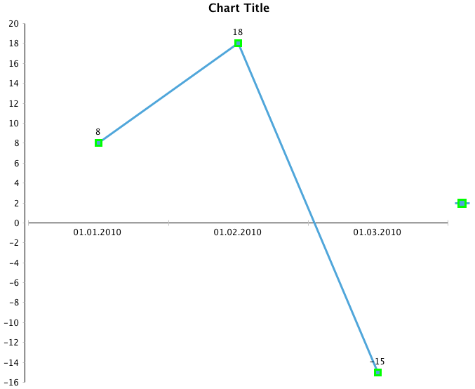

Then I adapted your example to demonstrate the two problems I have (see also attached screenshot). The full code is pasted below.
index.php/fa/7341/0/
First, the marker lines are not shown.
        MarkerLine ml = MarkerLineImpl.create(xAxisPrimary, DateTimeDataElementImpl.create(new CDateTime(2010, 2, 1)));
        ml.getLineAttributes().setStyle(LineStyle.SOLID_LITERAL);
        ml.getLineAttributes().setColor(ColorDefinitionImpl.PINK());
        ml.getLabel().getCaption().setValue("Some marker");
        xAxisPrimary.getMarkerLines().add(ml);
Second, the line color stays blue (even though the line markers are green). Interesting, the thickness of the line can be changed, but not the color.
        ls.getLineAttributes().setColor(ColorDefinitionImpl.GREEN());
        ls.getLineAttributes().setThickness(3);
Any hints?

Re: Chart SDK 3.7.2 - suddenly my marker lines and colors gone?! [message #809574 is a reply to message #808947] Tue, 28 February 2012 21:23 Go to previous message
Try adding:
xAxisPrimary.setCategoryAxis(false);
and
ls.setPaletteLineColor(false);
revised code below
> Any hints?
> protected static final Chart buildChart()
> ChartWithAxes cwaBar = ChartWithAxesImpl.create();
> // X-Axis
> Axis xAxisPrimary = cwaBar.getPrimaryBaseAxes()[0];
> xAxisPrimary.setType(AxisType.DATE_TIME_LITERAL);
> xAxisPrimary.getOrigin().setType(IntersectionType.VALUE_LITERAL);
> // Y-Axis
> Axis yAxisPrimary = cwaBar.getPrimaryOrthogonalAxis(xAxisPrimary);
> yAxisPrimary.getMajorGrid().setTickStyle(TickStyle.LEFT_LITERAL);
> yAxisPrimary.setType(AxisType.LINEAR_LITERAL);
> // marker line
> // Data Set
> DateTimeDataSet categoryValues = DateTimeDataSetImpl.create(new CDateTime[] { new CDateTime(2010, 1, 1),
> new CDateTime(2010, 2, 1), new CDateTime(2010, 3, 1) });
> NumberDataSet orthoValues = NumberDataSetImpl.create(new double[] { 8, 18, -15 });
> // X-Series
> Series seCategory = SeriesImpl.create();
> seCategory.setDataSet(categoryValues);
> SeriesDefinition sdX = SeriesDefinitionImpl.create();
> xAxisPrimary.getSeriesDefinitions().add(sdX);
> sdX.getSeries().add(seCategory);
> // Y-Series
> LineSeries ls = (LineSeries) LineSeriesImpl.create();
> ls.setDataSet(orthoValues);
> ls.setStacked(false);
> ls.getLabel().setVisible(true);
> SeriesDefinition sdY = SeriesDefinitionImpl.create();
> yAxisPrimary.getSeriesDefinitions().add(sdY);
> sdY.getSeries().add(ls);
> return cwaBar;
