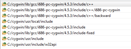

I was having the same problem, except mine was:
using namespace std;
[ std is ambiguous. candidates are ' ]
Some C++ project types have "built-in" settings for include paths, some do not. I copied the built-ins from a Hello World project and that seems to have fixed a multitude of sins. Unfortunately, the settings weren't written in the Export... file, and couldn't be copy/pasted, so I had to take a screen shot (attached here) and type them all in 1-by-1 (ughs....). Smile
