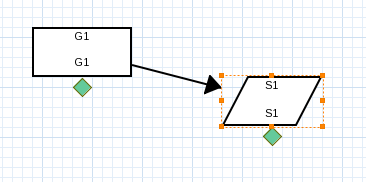

I have tried to implement the solution in accordance with the tutorial. The problem that arises is that the connection features connect to the outer invisible rectangle and not to the polygon itself.
index.php/fa/7287/0/
I have not been able to find any way around this issue. Sadly this is somewhat of a requirement for me as when the diagram get very crowded and the nodes become larger in size the connections can get misconstrued.
Unfortunately setting the referencedGraphicsAlgorithm on the chop box does not seem to help either.
In a previous instantiation I noted how I tried to use a BoxRelativeAnchor on another invisible polygon that lays on top of the visible polygon. There I was unable to avoid the selection of the frame surrounding the BoxRelativeAnchor. (The odd black box.)
Do you, or does anyone, have any thoughts on how I can proceed with this?
