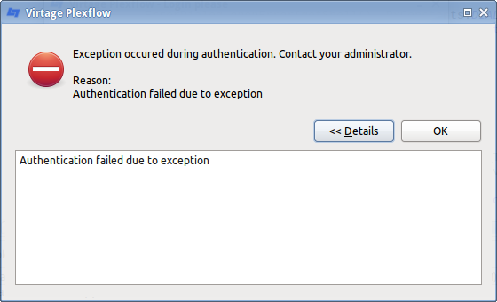

Why JFace ErrorDialog is not showing full stack trace (same like e.printStackTrace()) after pressing "Details >>" button? Actually it is showing just e.getLocalizedMessage() (i.e. just name of exception):
That's useless. It should contain similar output like e.printStackTrace() to be helpful:
