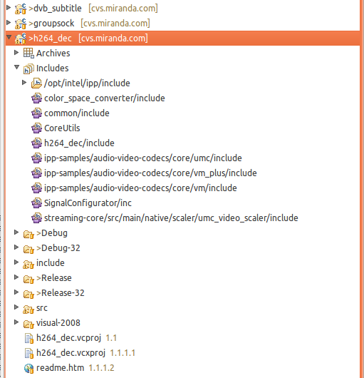

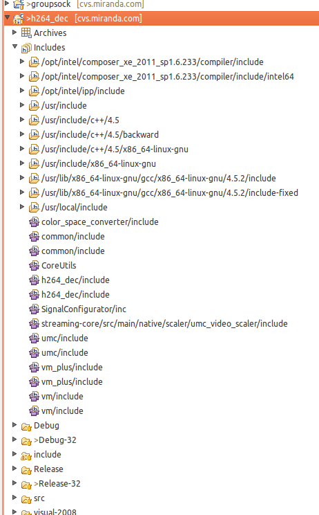

I have a complex CDT setup that uses over 20 projects to compile a few shared libraries. For some unknown reason as I add new projects one by one to Eclipse the old projects begin to lose the standard gcc and linux build-in include path as displayed in the C++ Projects window. I have observed that the moment I lose those paths the indexer begin to lose capability to find symbols and resource. At this point it is almost impossible to have a nice experience of the Eclipse IDE since the Indexer cannot resolve symbols. This seems to be clearly an issue and I would like to know if it has been reported.
I have attached 2 pictures of the same project that show different include path report as I add projects. Note that I am using the Intel C++ eclipse plugin. But I have tried to setup the projects with the GNU C++ compiler and experienced the same issue.

The problem happens only when Java projects are mixed with CDT projects inside the same workspace. When Java projects are mixed with CDT inside the same workspace and I add CDT projects eventually CDT projects seems to lose the standard include paths as shown in the attached picture. At this point the indexer seems to become confused and goes haywire displaying erratic and strange behaviour. Mostly the indexer doesn't seems to find the C++ symbols.
