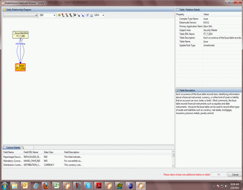

I have attached a screen shot of my application screen the boxes in the middle of the screen have check boxes I just need to record the clicks on the individual check boxes for testing purposes these are basically figures created using the draw2d library. When i click on this there is nothing recorded in the GEF Inspector window whereas other components out of the component are captured.

Thank you for the screenshot. I'd like to clarify one thing before recommending that you enter a ticket. You used the word "record" and said that clicking on other components causes them to be captured. Are you using the Observation Mode (started using the camera in the toolbar as described here) or are you using the Inspector, whose button is in the "Inspector View" and looks like a little blue man in a hat? The documentation for the inspector is here. The reason I ask is that the observation mode will not let you record GEF objects, and the inspector will not let you record clicks or actions on components like buttons etc. From your description it sounds like you may be trying to use the Observation Mode to collect GEF figures.
If you are sure that you are using the GEF Inspector, please enter a ticket in the Jubula Bugzilla containing a summary of this forum thread (stack trace, image, description of how the figures are created etc) as well as information on the version of Eclipse you are using, the system you are working on and any other information that will help us to analyse the problem. A snippet of the code used to create your figures would also be very helpful. You can then link to the ticket you create in this thread.

Yes I am using the recording button for recording the test case so just in the same way I assumed that when the GEF inspector is activated on a click we should see some ID or step that appears in the GEF inspector window.
I will open a ticket thank you so much for your help.
