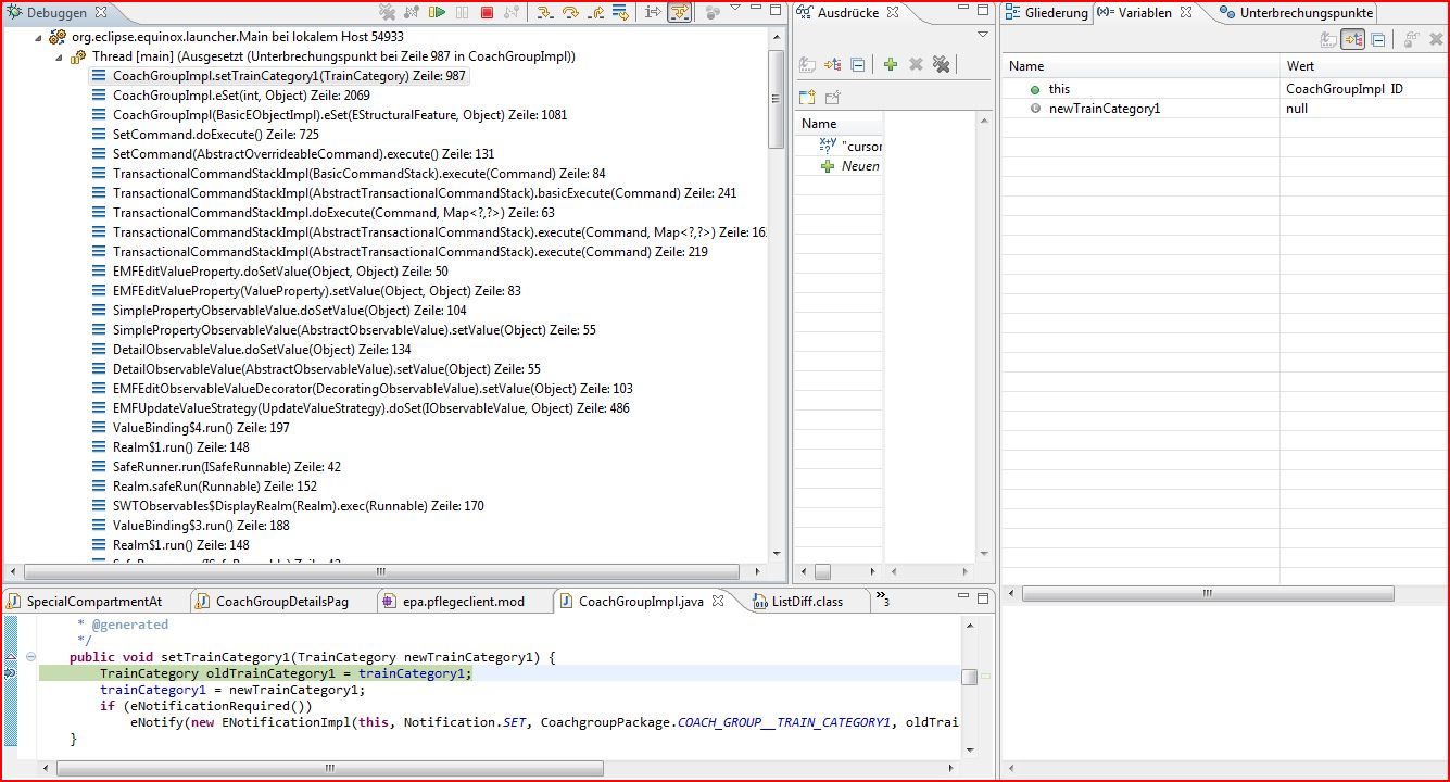

BUT now comes the problem....when I return the empty list the ValueBinding-stuff (see screenshot of stack) resets the trainCategory attribute (to null) of the old selected coachGroup1.
The selection changes, the getMasterTreeViewerObservable().getValue() return the fresh selection but the binding still is connected to the old selection.... is there an "observeDetail"-bug ? It seems that the binding gets refreshed after calculate is called and that would be very bad....then I would see no chance to use this combination of emf-binding and computed list.

This is a known "problem" in Eclipse Databinding. It's not really a bug
but not really solveable with the current API.
The only workaround i found is to dispose the selection-binding while
the master changes and recreate it afterwards.
