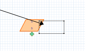

The observed behavior from this is that when I select on the polygon itself I do not get the selection box that you would expect, namely the one that defines the container shape allowing me to resize and move the container. I get a box that is related to the BoxRelativeAnchor. (see first attached image)

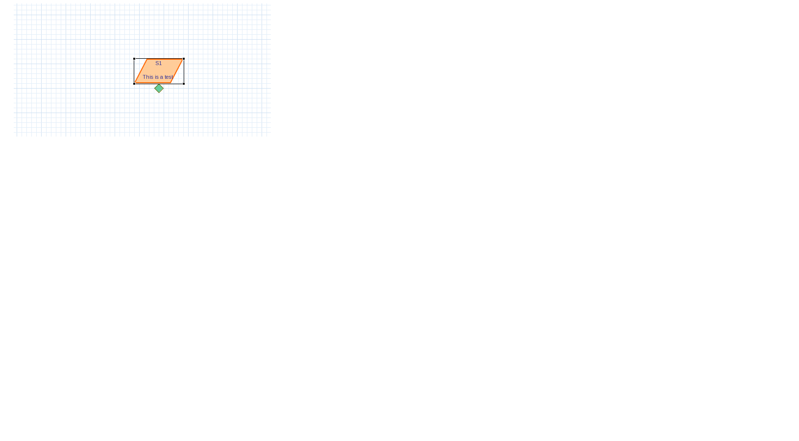

I make connections to this feature and I can select it (by clicking in the polygon)
and move it independently of the rest of the feature. (Although only within the limits of the outer container.) (see second attached image)

Try as I might I have not been able to turn off the selection of this box or to pass it back up the chain.
Is there something I am missing here in the way the BoxRelativeAnchor relates to the outer containerShape?
Is there no way to turn off the selection of the BoxRelativeAnchor? Or better yet, simply couple it with the outer containerShape or the visible polygon?
