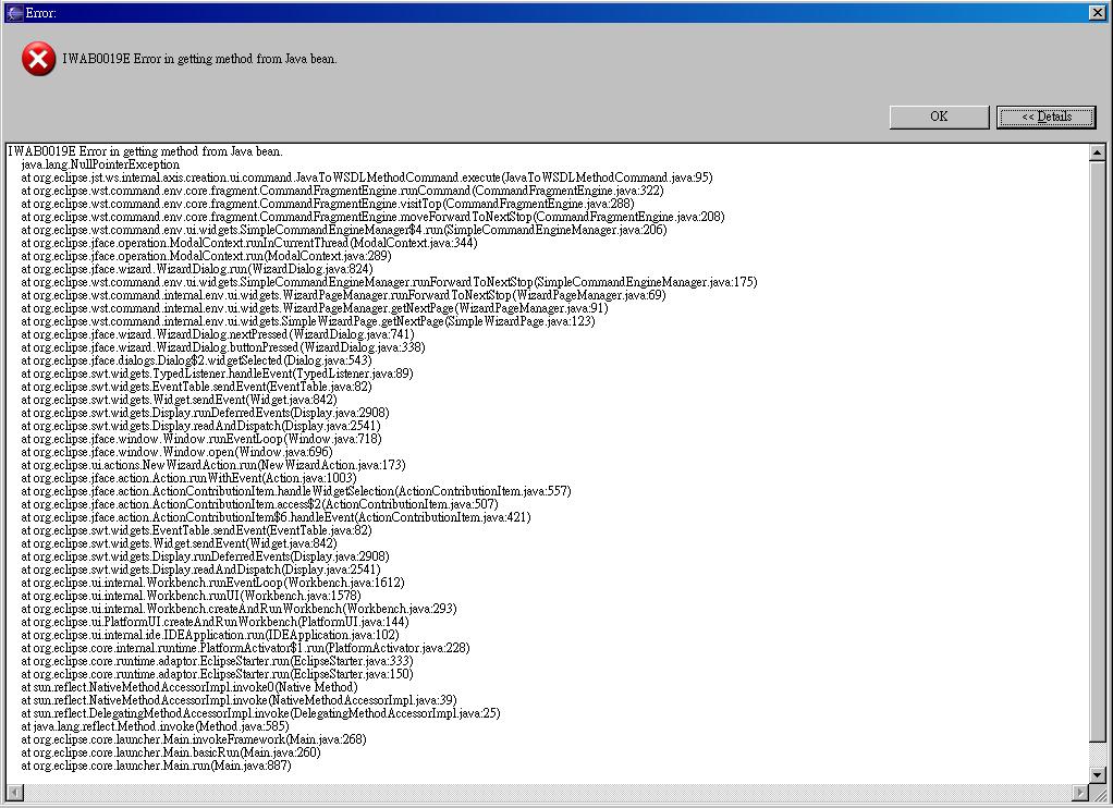

I got this error during new web service following the example Bottom up Web
Service Tutorial.
IWAB0019E Error in getting method from Java bean.

Originally posted by: kwcheong.gmail.com
Pls ignore it. I got this error because I just haven't select the Converter
class before newing the web service.
Now it works. Sorry about that.

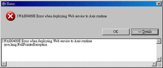

Re: Exception creating Web Servies example [message #94592 is a reply to message #94559] Sun, 24 April 2005 04:00 Go to previous messageGo to next message
Hey,
Oh, I still can't get thru, now when I click the finish button on the new
web service client I got the following error.
"IWAB0489E Error when deploying Web service to Axis runtime"

Re: Exception creating Web Servies example [message #94862 is a reply to message #94592] Mon, 25 April 2005 16:59 Go to previous messageGo to next message
Originally posted by: jbailo.vestcom.com
Make sure that tomcat isn't running on your system when deploying --
because Eclipse will start it for you.

Re: Exception creating Web Servies example [message #96381 is a reply to message #94862] Fri, 29 April 2005 23:25 Go to previous messageGo to next message
Yes, I did but I still got this error.

Re: Exception creating Web Servies example [message #99692 is a reply to message #96381] Thu, 05 May 2005 14:32 Go to previous messageGo to next message
Hi Frank,
Have you got a chance to try this with WTP M4? Try this tutorial and let us
know if you still have problem:
http://eclipse.org/webtools/jst/components/ws/M4/tutorials/B ottomUpWebService.html
Kathy Chan

Re: Exception creating Web Servies example [message #100520 is a reply to message #99692] Fri, 06 May 2005 17:37 Go to previous message
There is a problem in M4 with creating bottom-up Web service from a bean in
a default package. I've opened defect 94010 for that problem:
https://bugs.eclipse.org/bugs/show_bug.cgi?id=94010
I'll also add it to the News and Noteworthy document for M4.
Kathy Chan
