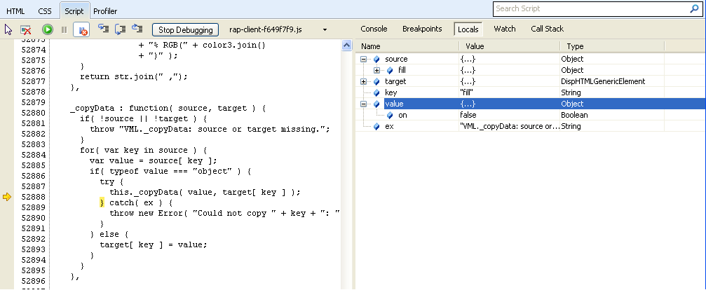

IE8 debugger says the exception occured in class qx.ui.core.Widget, method _autoFlushHelper
I commented out the RWT exception handler and thr try/catch block and this is what the debugger stopped on (see attached image)
Attached is an image of the debugger. I don't have a clue what the 'target' parameter should be, but looking at the code I expect it should have all the attributes that 'source' does. There is no 'fill' attribute in 'target' like there is in 'source'

Re: Javascript error: VML._copyData: source or target missing. [message #798023 is a reply to message #797886] Tue, 14 February 2012 01:15 Go to previous message
Chris,
we have this bug opened for some time:
364479: VML._copyData error in IE8
https://bugs.eclipse.org/bugs/show_bug.cgi?id=364479
but we are looking for a reliable way to reproduce it. Could you provide
a simple snippet that demonstrate the error?
Ivan
On 2/14/2012 3:29 AM, Chris Mising name wrote:
> Error: Could not copy fill: VML._copyData: source or target missing.
> description: Could not copy fill: VML._copyData: source or target
> missing.
> message: Could not copy fill: VML._copyData: source or target missing.
> Debug: off
> Phase: 3
> This is happening when a Dialog is being resized and some controls
> being added to it.
> It doesn't always happen, when different data is being added (and
> hence a different number of controls) it doesn't cause the error.
> It seems to only happen when the SharedScrolledComposite being shown
> has its scroll bar visible because the content doesn't fit. When I
> make the dialog expand enough to fit all results there is no error,
> when it has to scroll to fit there is an error.
> The widgets being displayed in the scrolled composite are Composites
> containing Label, CCombo and Button[CHECK] widgets.
> The same code had no issue with 1.5.0.20110928
> Currently using 1.5.0.20120209
> I'll try and find time to create something small to reproduce it but
> we're running out of budget on this project.
