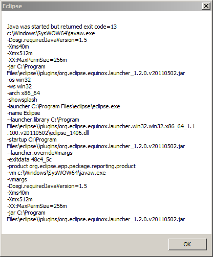

I tried running the new version of Eclipse from the command line with C:\Windows\SysWOW64 appended to the path.
Windows displayed the "wait" cursor for a few seconds, then returned to a normal cursor, and the command window displayed a new command line prompt.
A long time later (maybe 15 seconds), I got the error box shown in the attachment.
The pathnames with mixed slashes and backslashes drew my attention, and so did the ones with double backslashes. I tried both of those perversions in CD commands, though, and the CLP accepted them.

Try the 32 bit version here:
http://www.eclipse.org/downloads/download.php?file=/technology/epp/downloads/release/indigo/SR1/eclipse-reporting-indigo-SR1-win32.zip
Also open a command window and type in java -version.
My guess is you are running a 32bit vm instead of the 64bit vm
Jason
