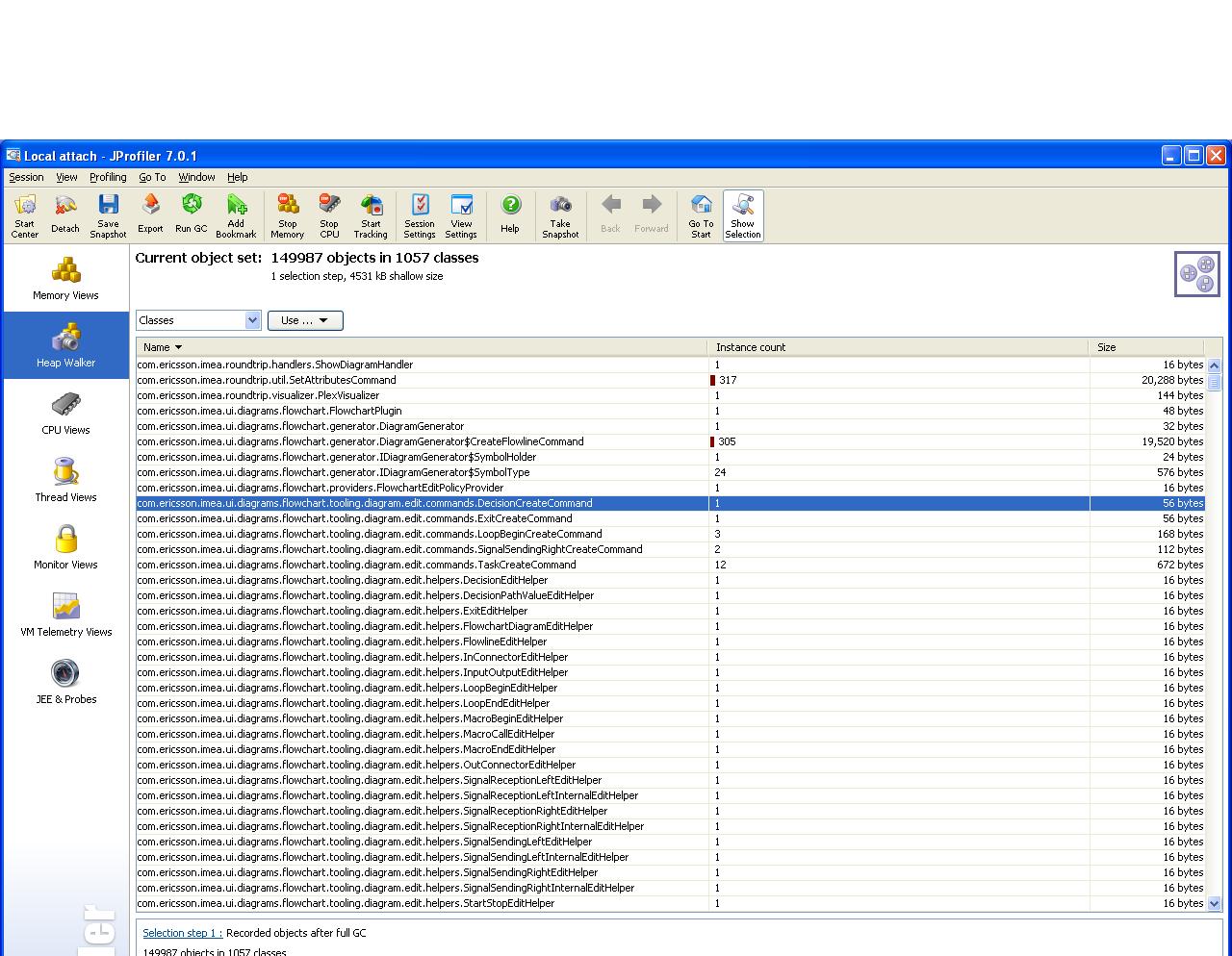

I am generating GMF diagram programatically.
I am creating the gmf symbols programatically by creating CreateViewRequest first and then creating by diagramEditPart.getCommand(createRequest);
Then i am executing the command using
diagramEditPart.getDiagramEditDomain().getDiagramCommandStack()
.execute(createCommand);
I am unable to dispose these commands,i am able to see the these commads even after calling command.dispose().
After completed diagram file is generated even the EditParts and EditPart figure also present in the Heap memory,see the attached JProfiler Report.
I am not opening/closing the diagram file at any point of time during my diagram generation.I am creating the gmf file using OffscreenEditPartFactory.
Can anyone Help me in this issue.
  • Attachment: Commands.JPG
    (Size: 236.96KB, Downloaded 223 times)
Re: Unable to delete Commands [message #793797 is a reply to message #793792] Wed, 08 February 2012 10:27 Go to previous messageGo to next message
what is the path to GC root of your command instance?
I suppose that it is retained by the CommandStack.
So you can limit the size of the stack or try to clean it.
