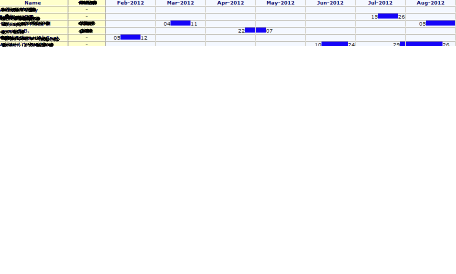

We have a custom JSP based (primitive though) report showing work schedules of employees. I have attached screen shot of the report.
Is it possible to do a similar kind of report using BIRT because we would like to use reporting capabilities of BIRT rather than a custom jsp based report. If so what kind of chart we could use for this?

Re: Chart Report For Work Schedules [message #793146 is a reply to message #792561] Tue, 07 February 2012 15:33 Go to previous messageGo to next message
That image looks like a cross tab and not a chart. I am attaching a
crosstab example report.
If you have some sample data in flat file or xml format I can show you
how to reproduce with your data.
Jason

Re: Chart Report For Work Schedules [message #793470 is a reply to message #793146] Wed, 08 February 2012 02:09 Go to previous messageGo to next message
Thanks a lot Jason for the feedback and reply.
I have another question, in cross tab report, is it possible to have some kind of an image or some thing like that to display the period range? If you look at the screenshot I have attached in my first post of this thread, we are displaying an image which is based on the date range. i.e. length of image size varies and depends on date difference.

Re: Chart Report For Work Schedules [message #793929 is a reply to message #793895] Wed, 08 February 2012 13:56 Go to previous messageGo to next message
I would like to have image inside a column. If you look at my screenshot
you could see image which shows the date range size. i.e. size of the image
varies on the number of days between starting date and ending
date.
Re: Chart Report For Work Schedules [message #793979 is a reply to message #793929] Wed, 08 February 2012 14:50 Go to previous messageGo to next message
I believe you could do this by inserting an image into the crosstab and
then writing code to create an image with appropriate size. The image
report item could then be scripted to use this new image as its data.
This would require java code to create the blue box with proper
horizontal size. If you can come up with that I can show you how to use
it in the report. You also may want to look at the Gantt chart type.
