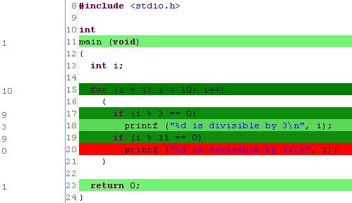

I compiled this code both with the --coverage or -fprofile-arcs -ftest-coverage options. Then I double-clicked on the gcno/gcda file and the GCov dialog opens up. I enter the correct path to the executable and select 'Show coverage details for ... only'. A nicely color coded editor window is presented as expected.
index.php/fa/7035/0/

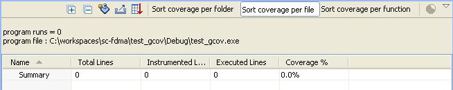

When I use the default setting however (Show coverage for the whole selected binary file), only zero values are shown.
index.php/fa/7036/0/
Is this a bug or is it a feature? Do I do something wrong?

It's certainly because gcov plugin is not able to find the gcno/gcda files produced by you binary. Check the eclipse error log: you will certainly found an entry saying something like "An error occured during analysis: unable to retrieve gcov data"
The way all gcda/gcno files are found by gcov plugin is currently not perfect.
For now, it depends on the external program "strings".
Is this program available on your Cygwin installation ?
Xavier Raynaud
Re: Eclipse, CDT, Cygwin: GCov panel shows zero values [message #797388 is a reply to message #792302] Mon, 13 February 2012 07:28 Go to previous messageGo to next message
Hi Xavier,
thanks for your reply. I checked my cygwin installation and the strings program is available. It has version
GNU strings (GNU Binutils) 2.22.51.20111013
Furthermore I checked for an error like you described. I could not find any. I guess, the files must be found anyway, because the code back-annotation works well. It is just the summary, which does not work.
Re: Eclipse, CDT, Cygwin: GCov panel shows zero values [message #800000 is a reply to message #797388] Thu, 16 February 2012 10:01 Go to previous message
Hi Hans,
I'm sorry, I was not able to reproduce with the following config:
- Windows 7
- eclipse Indigo
- CDT 8.0
- cygwin
- GNU strings (GNU Binutils) 2.22.51.20111013
Note: I've "C:\cygwin\bin" in system Path
Perhaps you can fill a bug, with a tar-ball of your project, and the content of the ".metadata/.log" file ?
