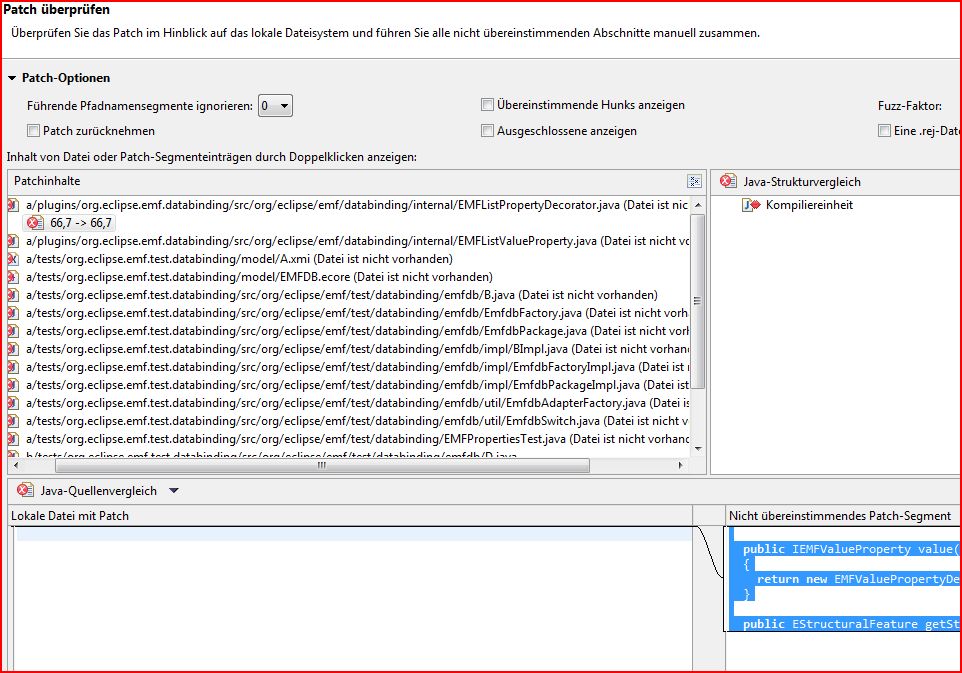

Re: Binding: List (want first Element) in Feature Path [message #798948 is a reply to message #798904] Wed, 15 February 2012 04:00 Go to previous messageGo to next message
In my workspace with the patch it works like a charme and fails with the
same NPE without it => the patch fixing your problems.
If you grab the next build things will work as desired. I also tested
master-detail stuff and it also works without any problems and attached
you the modified test case.
Tom

Re: Binding: List (want first Element) in Feature Path [message #798964 is a reply to message #798948] Wed, 15 February 2012 04:25 Go to previous messageGo to next message
Ok, that would be nice....so the path can be found here ? https://bugs.eclipse.org/bugs/show_bug.cgi?id=354016
Is it this 3.3kb File ? The "+" and "-" at the start of the lines seem to be change informations. Now how do I get the changes to my Eclipse ? Or is there a new EMF Version I can download from somewhere ?
Re: Binding: List (want first Element) in Feature Path [message #798972 is a reply to message #798964] Wed, 15 February 2012 04:40 Go to previous messageGo to next message
No the attached patch is not the correct one!
To get it in your workspace you have 3 options:
a) wait for a new emf build
b) import the emf-databinding sources (emf.databinding and
emf.databinding.edit) and apply the following patches:
Mandatory:
http://git.eclipse.org/c/emf/org.eclipse.emf.git/commit/?id=d248dbac47b4dc3e5cbeef790aab9080f39348ae
http://git.eclipse.org/c/emf/org.eclipse.emf.git/commit/?id=f1f31f988335b9e4ea431ac94b8565a63c48c495
http://git.eclipse.org/c/emf/org.eclipse.emf.git/commit/?id=c5152a44a0f14764b3180c2567270170f3670fb1
Optional one but brings some performance into the game:
http://git.eclipse.org/c/emf/org.eclipse.emf.git/commit/?id=8359628c6f8312eba85a2044884626c045b51378
c) Clone the git-repo and import emf.databinding and emf.databinding.edit
a) would mean that up-grade your whole EMF (which should not be a
problem because it is fully backward compatible)
b) is some work and hard to maintain
c) easiest if you can someone get you to install egit into your eclipse
workspace and keep up with databinding changes
Tom
Am 15.02.12 10:25, schrieb Markus Jo:
Re: Binding: List (want first Element) in Feature Path [message #798997 is a reply to message #798972] Wed, 15 February 2012 05:11 Go to previous message
I am falling into despair...
Option b)
I am to dump!
The patching does not work....when I used your attached Patch I get compile errors because the constructor EMFListValueProperty(eStructuralFeature, elementAccess); is not there anymore.
When I try to apply the three other patches I always get something like in the attached jpeg....File not Found....even if i mix the order, nothing happens.
Behind the three mandatory links I can find zips to download which are full of plugins. Would it be a possibility to download the zip of one of the three links (which one), copy it into my eclipse folder and the apply your attached patch afterwards ?
Option c)
To dump all the more!
Option a)
I think I would get that working....but what do you think how long I will have to weit for the next build ? This will be a so called stable build, right ?
