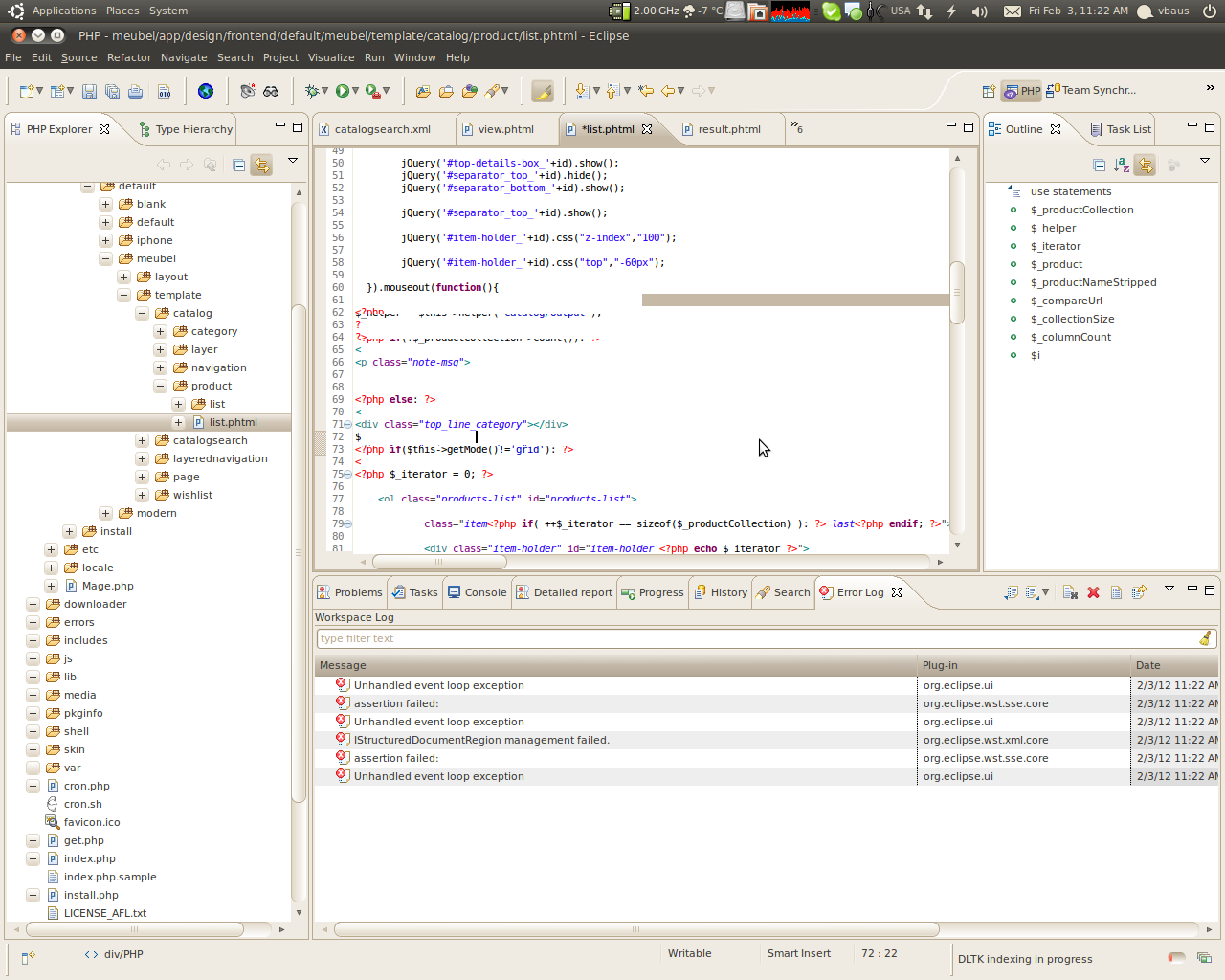

I'm experiencing some problems using Eclipse. I'm using eclipse indigo 3.7.1 64 bit version for Linux on Ubuntu 10.04, and at random times the editor just goes crazy. It would not input nor display text correctly. It's kinda hard to describe what it does, so I'll just upload an image. These are the things currently installed:

I've attached a detailed error log. I'm no java developer and have absolutely no idea what could be the problem here. Also, "reinstalling" the eclipse does not help, the problem appears over and over again. So if anyone has any ideas, it is greatly appreciated!

Your environment apart, the parser of PDT 3.0.0 is being broken and is being abandoned.
See https://bugs.eclipse.org/bugs/show_bug.cgi?id=350139
also 349127,350379,350468,351737,353376,357868,365837,366313,368510,369320,etc.
You can try Zend-PDT - These downloads include Eclipse 3.7.1 and PDT 3.0.2 (see http://www.eclipse.org/pdt/downloads/)
or personal(unofficial/unorthorized) feature patch - http://sourceforge.jp/users/atlanto/pf/eclipse/files/?id=435
