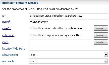

i've been reading through some articles because i wanted to make some of my views not closeable.
i saw Vogella's tutorial on rcp here (i know that this sample is based on indigo and not helios)
which contains this image:
http://www.vogella.de/articles/EclipseRCP/images/xaddview130.png.pagespeed.ic.-g3W7gfWGu.png
my version of eclipse(helios) only shows me less:
index.php/fa/6985/0/
thats why i looked into documentation here

so i opened my plugin.xml
and edited the stuff just in place instead of the visual editor:
<view
            allowMultiple="false"
            category="myCategory"
            class="package.to.DetailView"
            icon="icons/siteEditor_perspective.gif"
            id="detailview"
            name="%ViewDetails"
            closeable="false">
      </view>
but when i load up my perspective the view is still closeable...
any ideas?
