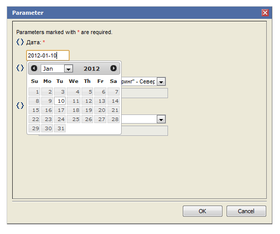

I want to use dynamic combo-box parameter.
index.php/fa/6984/0/

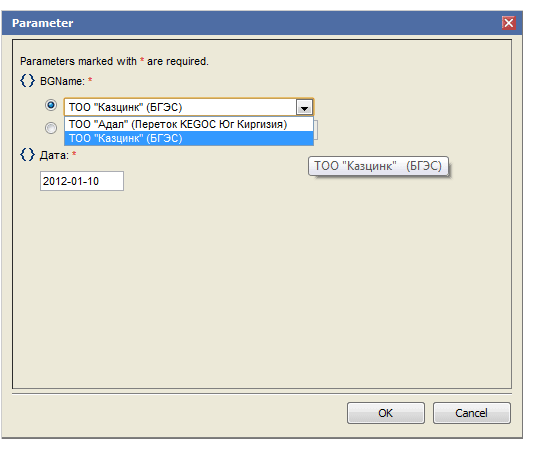

But data set for this combo-box use parameter too. It's Date.
index.php/fa/6983/0/
How can I do it?

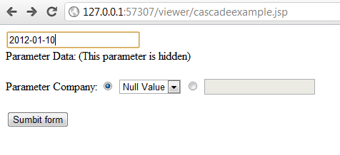

Re: Parameters [message #789524 is a reply to message #789239] Thu, 02 February 2012 23:23 Go to previous messageGo to next message
I found example about cascading parameter group. It use Data set with a limited set of dates for Dates parameter.
But I use calendar, where I can select any date.
index.php/fa/7009/0/
And then can I use this parameter (picked from calendar) in the cascade parameter?

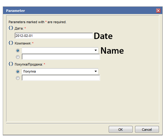

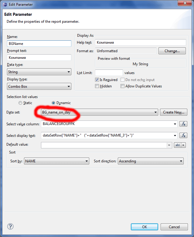

Re: Parameters [message #794329 is a reply to message #793140] Thu, 09 February 2012 01:35 Go to previous messageGo to next message
Thanks. I made JSP Parameter page:
index.php/fa/7093/0/
And I can select Date here. Then press "Submit" and get Parameter page, where I can select Company for that day.
index.php/fa/7094/0/
But can I refresh and select parameter Company on JSP page too? and skip then Parameter page.
