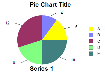

I have created a pie chart in birt.
I want to implement functionality like, when any user click on my any part of my pie chart(plz refer below attached image)it should need to be explored in another pie chart or tabular format so that he can see details regarding selected part deeply.

Take a look at this post:
http://birtworld.blogspot.com/2010/05/more-on-chart-interactivity.html
and
http://birtworld.blogspot.com/2009/12/calling-client-side-javascript-from.html
