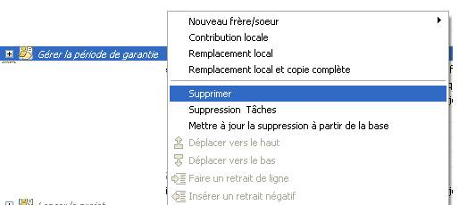

I have a method developped with EPFC 1.5.0.4.
When I upgrade EPFC to version 1.5.1.2 (and now 1.5.1.3), I got a problem when I modify the Delivery Process.
In the initial situation, I have tasks "derivated" from a Capability Pattern.
index.php/fa/6844/0/
[We made modifications on this capability pattern, but I have the same problem with unmodified CP.]
When I "delete" a task, to not "derivate" it in my delivery process, I have a good result ... but only when EPFC is Open.
index.php/fa/6845/0/
Indeed, if I close and re-open EPFC, all the tasks are "derivated".
index.php/fa/6846/0/
NB : For an other Delivery Process with that problem, I re-create it ... and I don't have this problem !

I've got "Problems" signaled in the Problem thumb.
Using "quickfix" to resolve them, I've resolve the problems into the delivery process !
