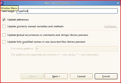

When we do a refactor --> rename of a java file, Test.java . The following is happening:
- Rename compilation Unit is showed (refactor_rename_step1).

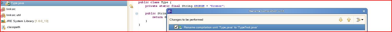

- The file is checked out. Test.java (changes_to_be_performed).

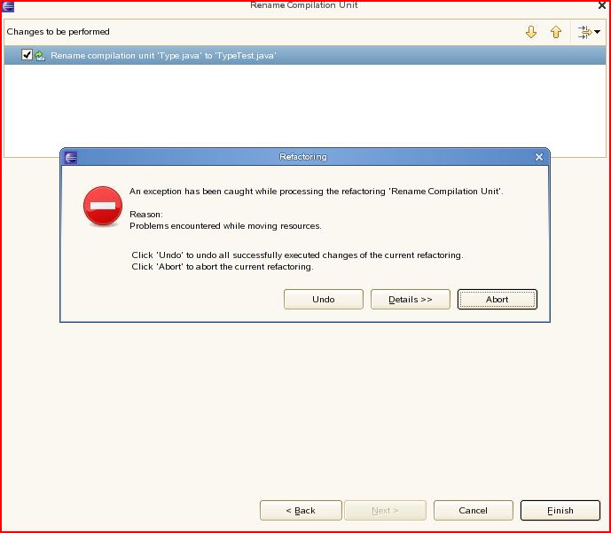

Then I cancel and an option to Undo is visible (cancel_move).
- I select "Undo" and the dialog is closed but the file is still checked out.

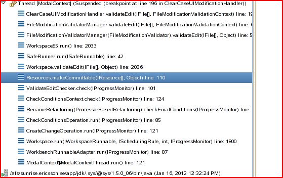

I have added a stack trace for Creating changes ... (create_changes_stack_trace).
Q2:I don't see how it is possible to add Undo when the validateEdit is called?
JDT expects the file to be in the workspace and has no knowledge of the
version control system you are using. The problem should be with the
Clearcase plugin.
The attached picture,create_changes_stack_trace, shows that a call is made to validateEdit() from This is not initiated by clearcase plugin. See stacktrace picture.
A repository plugin must implement the validateEdit() - method but it is not called from clearcase plugin.
br,
//mike
Re: Refactor rename undo not working [message #780683 is a reply to message #780517] Wed, 18 January 2012 21:40 Go to previous messageGo to next message
Of course, the Clearcase plugin participates in the refactoring via some
extension mechanism but that does not make JDT responsible for what it does.
Please take it up with Clearcase plugin providers.
Deepak Azad
http://wiki.eclipse.org/JDT/FAQ
Re: Refactor rename undo not working [message #780699 is a reply to message #780683] Thu, 19 January 2012 01:13 Go to previous messageGo to next message
What mechanism do you refer to? The only mechanism that I can see in the clearcase plugin code is is that org.eclipse.core.resources.IFileModificationValidator.validateEdit() is used.
What shall be used instead for a refactoring --> rename? It is called from RenameRefactoring ( according to stack trace). So what is missing in implementation?
