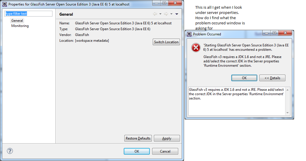

I'm trying to run glassfish but I keep getting an error stating that I need to select a jdk in server properties window and select a jdk in the runtime environments section but I cant find it
I posted a screen shot of what I'm seeing
or check attachment
Please help

Re: problem installing and running glassfish v3 [message #777595 is a reply to message #777153] Tue, 10 January 2012 14:30 Go to previous message
> or check attachment
> Please help
I believe "Server properties 'Runtime Environment' section in the
"Problem Occurred" dialog is actually referring to the Server ->
"Runtime Environments" preference page. On this page, select the select
the Glassfish runtime and click Edit. If the Glassfish support is like
the other WTP servers, you will find the selection for the Java runtime
to use. For Glassfish, this Java runtime needs to reference a JDK
instead of a JRE. Since I am not familiar with what the Glassfish
Eclipse plug-ins actually implement, I could be wrong about this.
Cheers,
Larry
