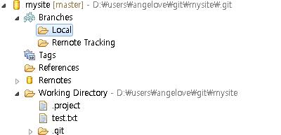

Re: git remote add [alias] [url] [message #792443 is a reply to message #789668] Mon, 06 February 2012 20:57 Go to previous messageGo to next message
how can i create local branch?
there is no create menu by right click at local.
  • Attachment: 3.JPG
    (Size: 11.77KB, Downloaded 565 times)
Re: git remote add [alias] [url] [message #793742 is a reply to message #792443] Wed, 08 February 2012 09:03 Go to previous message
If you commit a change, the branch "master" will automatically be created. Then you can create a new branch, if you right click on the repository, and then choose "Switch to" -> "New branch".
Since branches are pointers to a commit in Git, you must have at least one commit, otherwise there is nothing a branch could point to.
