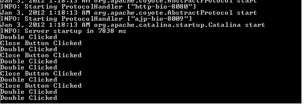

Re: JMeter | Popups | Added Sample TestCase [message #774065 is a reply to message #773105] Tue, 03 January 2012 02:49 Go to previous messageGo to next message
Since i was not getting the desired results..
I have created a test sceanrio.
1)Modified the org.eclipse.rap.demo to produce my sceanrio.(Source Code is Attached)
2)Double Click on (View ||| -> Root -> Parent 2)
3)Custom Message Box will appear.
4)On Tomcat Console - ( Double Clicked ) is printed.
5)Close Pop up using the X icon - (Close Button Clicked) is printed on tomcat console.
I have done steps 2,3,4,5 in the JMeter Loop Controller. So that they can be done mutiple times.
Added the test case (Test Case is Atatched). It can be run through Jmeter GUI.
Notice in the test case - loop Controller(loop count = 3)
Expected Result - Message Box should be opened and closed 3 times from the controller.
Actual Result - Message Box is opened and closed only once.
Test Case Env - Tomcat apache-tomcat-7.0.23, RAP 1.5M4, Dorg.eclipse.rwt.enableUITests=true
In the second round of the loop controller , the server json does not produce the correct json output.(Attached ActualResult.jtl)
Notice the response in /sapphire/rap;jsessionid=${snum}?nocache=1325570039896 which is not correct second time.

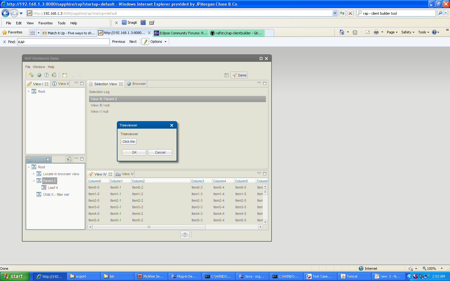

Re: JMeter | Popups | Added Sample TestCase [message #774067 is a reply to message #774065] Tue, 03 January 2012 02:56 Go to previous messageGo to next message
Added Modified Dialog Screen Shot
