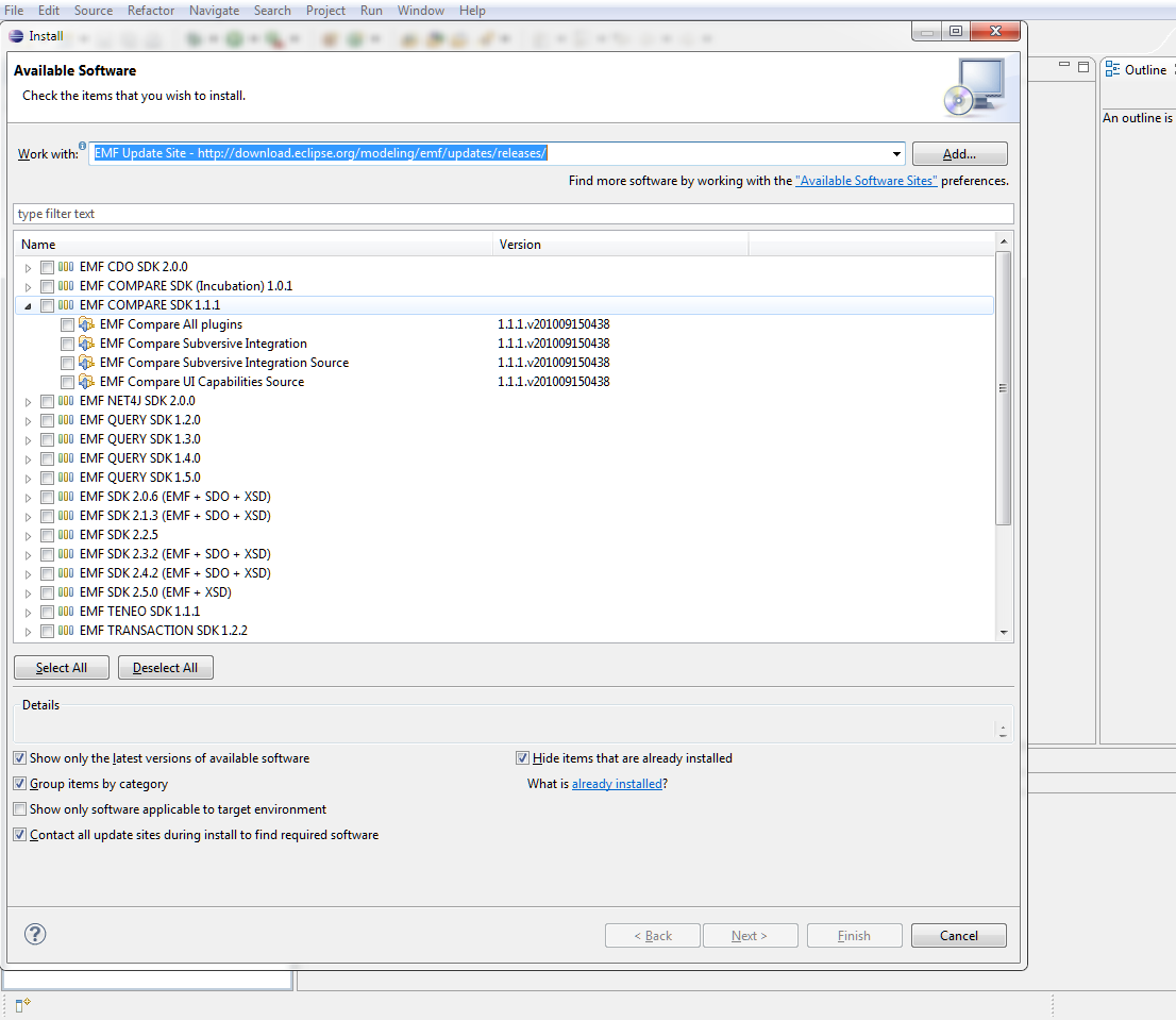

However I installed EMF Compare (please see the attached screenshot file for details).
What am I missing? I also checked download . eclipse . org/modeling/emf/updates/releases/ but it brings EMF Compare SDK 1.1.1 and not 1.3.0 (please see the second screenshot).

Re: Cannot install Intent [message #770156 is a reply to message #770124] Fri, 23 December 2011 08:47 Go to previous messageGo to next message
Hi Emre,
we recently added this strong dependency toward the latest version of
EMFCompare because we found blocking bugs with previous versions.
I think the easiest way to get EMF Compare 1.3.0 is :
- to start from a Juno Modeling Eclipse
or
- to use the EMF Compare update site
http://download.eclipse.org/modeling/emf/compare/updates/nightly/1.3
Let me know if you encounter any other issue, sorry for this dependency
problem.
Alex
