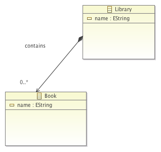

How can I re-use data that I've persisted earlier, using an older version of my Ecore model schema, after making changes, e.g addition of a new Ecore class and creating a new relationship?
For example, suppose that for the first version, I create a Library class and a Book class. I create the eclipse EMF plugin and create a new library project and add some books to the library.
For the second version, I add an Author class and model the relationship between the Book, Author and Library classes.
I've noticed that after I regenerate the new plugin, I am unable to right click on the Library model element and add a new Author.

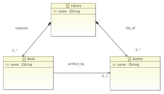

Hi Ed,
I tried it once again carefully, and it worked. I don't know what went wrong earlier.
The last time, I'd manually re-load the genmodel, this time around, I noticed that the genmodel was
always in sync with the changes made to the ecore diagram.
I've attached screenshots and the model project with this message. Its working fine now.
I've come across COPE (Coupled Evolution of Metamodels and Models) which takes things a bit further and allows you to build a migrator, to convert models if the meta-model changes.
While building this example, I changed the relationship between Book and Author from "has" to "written_by", and it automatically picked up the changes while loading an older version of the model, which had the "has" relationship.
So, to what extent does EMF actually insulate or preserve existing data, from changes to the meta-model / Ecore model schema?
Elvis Dowson
