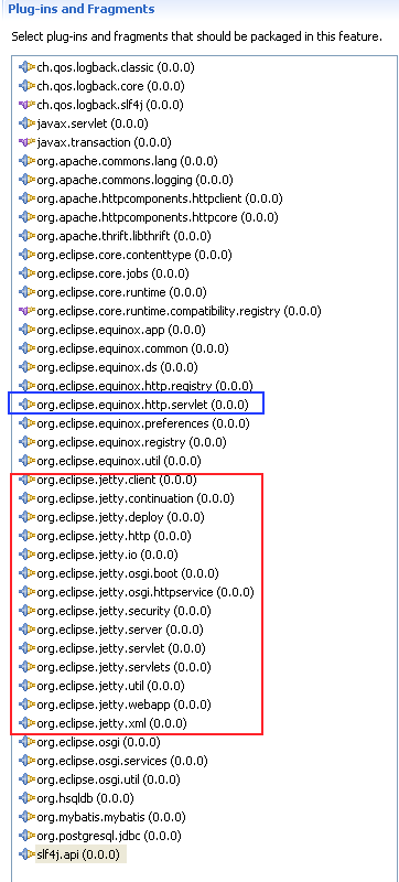

On the current project we are using Equinox 3.6 and Jetty 6.1.23. So we decided to upgrade Equinox up to version 3.7.1 (latest release) and Jetty up to version 7.5.1 (latest release).
During the Equinox upgrade we noticed that bundle 'org.eclipse.equinox.http.jetty' contains references to the old Jetty libs of version 6.1.23 (org.mortbay.*) which were removed in Jetty 7.5.1.
Such restriction prevents us to upgrade Jetty.
Does anyone faced with such situation? Probably there is updated 'org.eclipse.equinox.http.jetty' lib for Equinox 3.7.1 compatible with Jetty 7.5.1 somewhere? I will highly appreciate if someone could provide the link to download such lib version if it exists?

Unfortunately Equinox did not upgrade to support jetty 7. I think the eclipse jetty project does have some support for the http service with jetty 7 so you may have some luck finding support there. For the Juno release Equinox is upgrading to jetty 8 and servlet 3.0.

It is not apparent to me what you need: whether a target platform or an
IDE. I have been using eclipse 3.7 and jetty 7 together to host web
applications as well as to use HttpService. So, if you were talking
about the target platform I could give some details. You might want to
look at the target platform I use, in this case you should see the
attachment.
