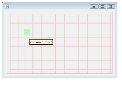

I have installed WindowBuilder on my Eclipse Indigo. And I've noticed a strange thing.
Designer set a border for contentPane with 5 pixel insets (for default):
contentPane.setBorder(new EmptyBorder(5, 5, 5, 5));
If I choose a GridBagLayout, I will see that grid represents with an addictional displacement (right and down). The objects, however, are placed in a right places. (see the screenshot)
index.php/fa/6428/0/
Is it a bug or a feature?
p.s. I'm Russian, sorry for my poor English.

This has been fixed in trunk.

No. I would say that it is very common terminology. It means that the issue has been fixed in the trunk directory of the WB SVN repository.

We don't have any building instructions.
You should just use the latest integration build.
