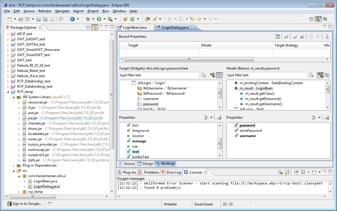

Displaying that code shows the following in the windowbuilder bindings view:
index.php/fa/6429/0/
The bean/field m_result is missing in the bindings view.

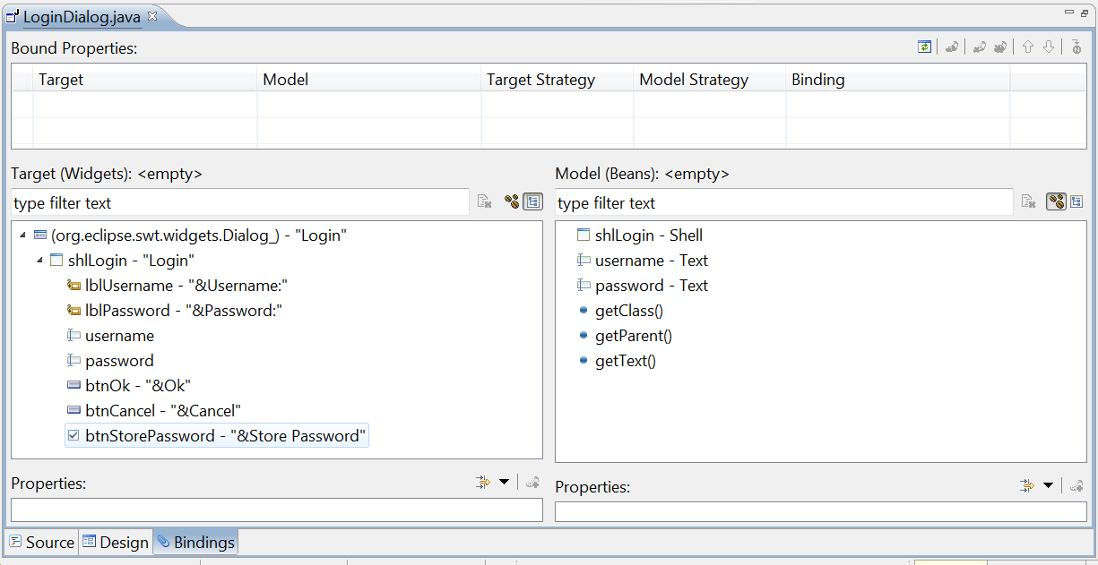

I just need to change the type of m_result to 'Object' and it looks like this:
index.php/fa/6430/0/
As you can see, m_object appears in the beans list.
See my problem?

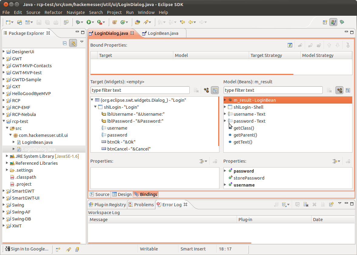

Re: Problem with databinding [message #764960 is a reply to message #764775] Tue, 13 December 2011 02:11 Go to previous messageGo to next message
Can not reproduce this case.
In test project (see attached) all shown (with given sources).
index.php/fa/6452/0/

Re: Problem with databinding [message #765441 is a reply to message #764960] Tue, 13 December 2011 23:08 Go to previous messageGo to next message
Tried that on Java 7 as well? Could that come by a missing dependency? (My project is Maven dependency managed)
Re: Problem with databinding [message #767114 is a reply to message #765441] Fri, 16 December 2011 22:43 Go to previous messageGo to next message
I've analysed your rcp-test project. You used Eclipse 3.6.2 to tell me you couldn't reproduce it where I wrote I have this problem with Eclipse 3.7.1. I use Java 7, you use Java 6. Can you try that again in the given environment, please?

Re: Problem with databinding [message #769531 is a reply to message #767114] Thu, 22 December 2011 03:59 Go to previous messageGo to next message
All works properly!
Used Eclipse 3.7.1 with Java 7u2.
index.php/fa/6530/0/

Re: Problem with databinding [message #769860 is a reply to message #769531] Thu, 22 December 2011 14:52 Go to previous message
I also tried it with Eclipse 3.7 and JDK 7 and it worked fine for me as well.
