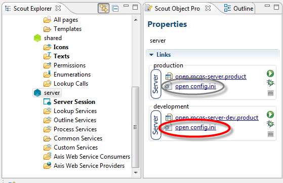

I think you missed the fact, that you can "configure" (eg call a setter function in a service) from a config.ini file.
In the scout Perspective open the config.ini file of one of your server config.ini (for example /<your app>.server/products/development/config.ini)
index.php/fa/6381/0/
change (or add if missing):
### Service Runtime Configuration
org.eclipse.scout.rt.server.services.common.file.RemoteFileService#rootPath=<<YOUR VALUE HERE>>
That way you do not need to change the RemoteFileService.
