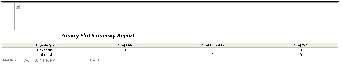

We have integrated BIRT in our application and sample code is as below. the images are embedded in reports. Now the problem is that images are appearing in tomcat but not in weblogic (attached screenshot).

My guess is the sc.getRealPath is returning null when you are trying to
set the image directory.
Take a look at this post:
http://reach2ramesh.blogspot.com/2010/01/weblogic-servletcontextgetrealpath.html#!/2010/01/weblogic-servletcontextgetrealpath.html

Hi Jason,
It is appearing in the PDF and Excel but not in HTML.
Re: Embedded Images are not appearing in Web logic [message #915954 is a reply to message #915936] Tue, 18 September 2012 05:36 Go to previous messageGo to next message
I got it working by changing the weblogic.xml
<container-descriptor>
<show-archived-real-path-enabled>true
</show-archived-real-path-enabled>
</container-descriptor>
Thanks Jason.
