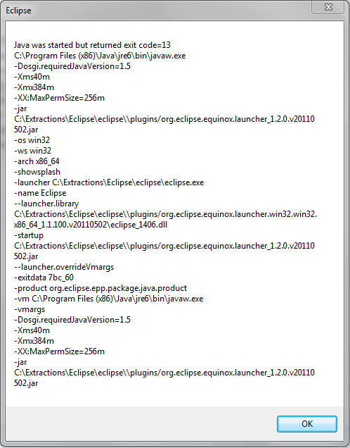

and I guess I should have looked a few minutes more before posing this *doh* I was not pointing to the exe- Now I am getting an error but reading through it it is throung out win os 32 and I am running 64 so I am guessing my versions do not match- I will follow up
Edit:
*following up*
The I have verified I am running java for 64bit and I when I downloaded eclipse I picked 64bit... I have no clue what the problem is... I will attach the message thrown...
*following up following up*
I pointed my ini to look in program files not program file x86 and it works now

How did you verify that you're launching a 64-bit Java VM?
Re: failed to load shared library [message #762365 is a reply to message #760738] Wed, 07 December 2011 19:05 Go to previous message
i guess i *didn't* i just managed to get it working which is all I care about @ this point lol
Once I am more familiar with the IDE I will refine it to verify that java is 64bit and eclipse is as well
