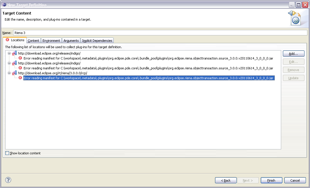

My platform: Current Indigo 3.7 RCP & RAP (fresh download & installation) on Windows XP
I followed the Getting Started guide on the wiki step by step:
Adding the Equinox and RCP targets is no problem at all. However, when I add the Riena Target Components the whole target content definition goes sour.
The error message given is: "Error reading manifest for C:\workspace\.metadata\.plugins\org.eclipse.pde.core\.bundle_pool\plugins\org.eclipse.riena.objecttransaction.source_3.0.0.v20110614_3_0_0_0.jar" (see attached screenshot)
I've checked the jar file with an external archiver and indeed it appears to be corrupted. Could you check whether the jar on the server is in fact broken? Or am I doing something wrong? Should I just download the zip for Windows users? If the latter is recommended, I suggest to change the wording to indicate, that it is required to do so, rather than optional.
Cheers
Julian
