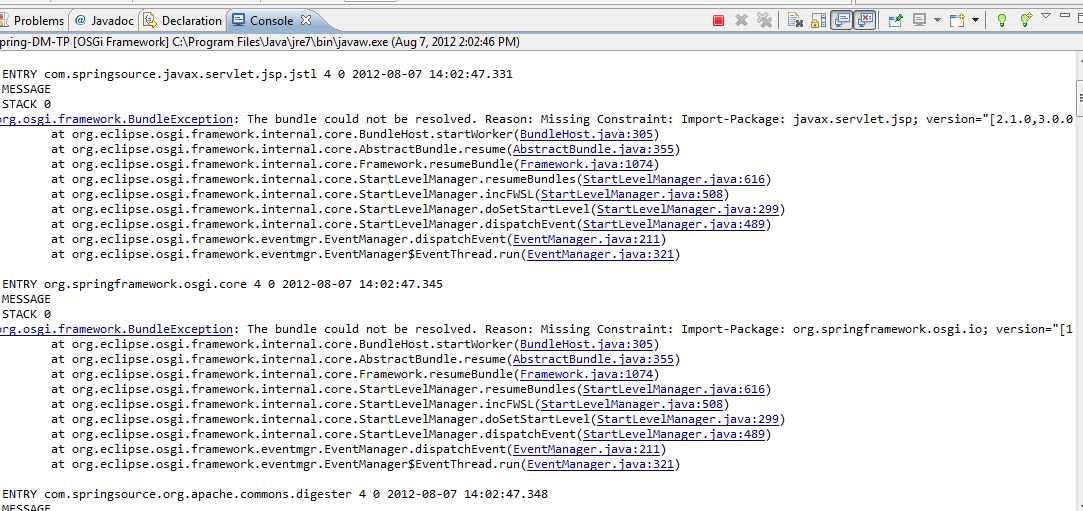

When running the app inside Eclipse Indigo... i am getting following error....
i think this is coming due to some version problem.... or because of some jar file not available....
i am new to this.. can anyone help me out.... i am trying to run tutorial at springosgi/ch01.html
!SESSION 2012-08-07 14:02:46.344 -----------------------------------------------
eclipse.buildId=unknown
java.version=1.7.0_05
BootLoader constants: OS=win32, ARCH=x86_64, WS=win32, NL=en_US
Command-line arguments: -dev
other error shown in screenshot attached
  • Attachment: err.png
    (Size: 67.70KB, Downloaded 1054 times)

Hi Vishal, Have you solved this problem? I'm having the same. Thanks.
