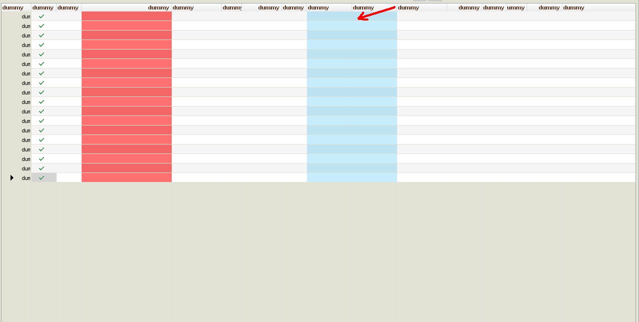

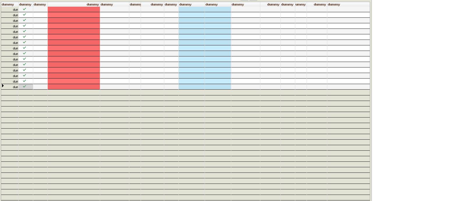

I have a SWT table in my RAP application. The gridLines visbility is set to true. But the table renders quite differently in IE and Mozilla. I have attached the screenshot for both.
The main problem is that in Mozilla, the background color of the cells covers the vertical grid lines. which is makes it difficult to differentiate between 2 cells of the same color.
Secondly,in IE the horizontal grid lines are black and the vertical are not, whereas both the lines should be non black.
Any idea why this is happening and what could be the possible solution?

This sounds like this bug (which is already closed):
364578: [Table][Tree] cell-background paints over vertical gridline
https://bugs.eclipse.org/bugs/show_bug.cgi?id=364578
If you are experiencing a different issue, please file a bugzilla.

Thanks Rüdiger.
That's correct. The first issue is exactly whats in the bug.
As mentioned the second issue is that the horizontal and vertical grid lines have different colors in IE. How to fix this?

Please file a bug for the second issue.
