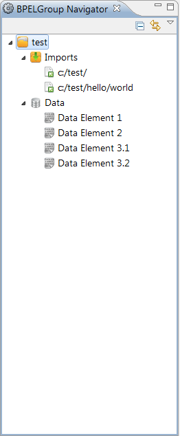

The goal of the project is to group existing projects inside the workspace under one "super project". I am using a custom navigator because I only want to see my own projects.
Example project in my navigator:
index.php/fa/6238/0/
The above image shows the visualization of the following project artifact

I have no problem with the visualization itself. My problem is that I don't know how/where to make sure that the view is in sync with the model.
