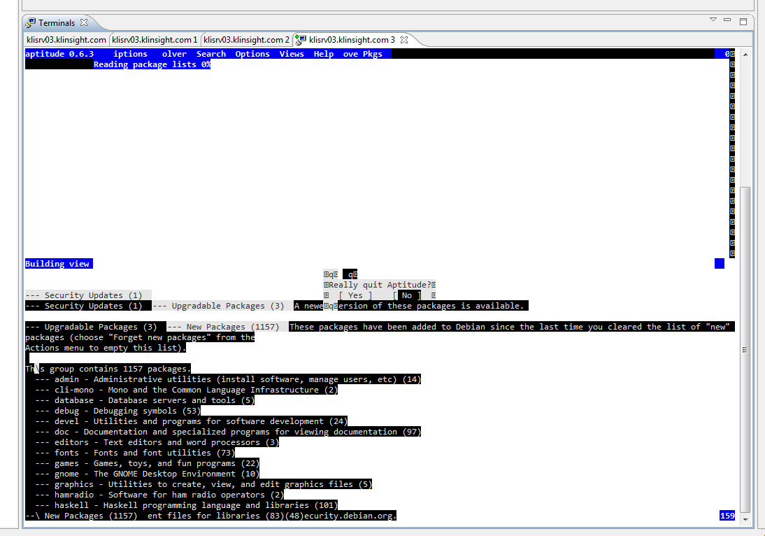

Hi Martin,
Sorry for the super late reply, I have tired your suggestion and as per the image below things are better but still unusable and badly broken with programs like aptitude and nano. Using version:
Target Management Terminal 3.3.1.201209191030-7N7FF8P7iMmAV6aAkqxqHKN8 org.eclipse.tm.terminal.sdk.feature.group Eclipse TM Project
Any other ideas?
Daniel

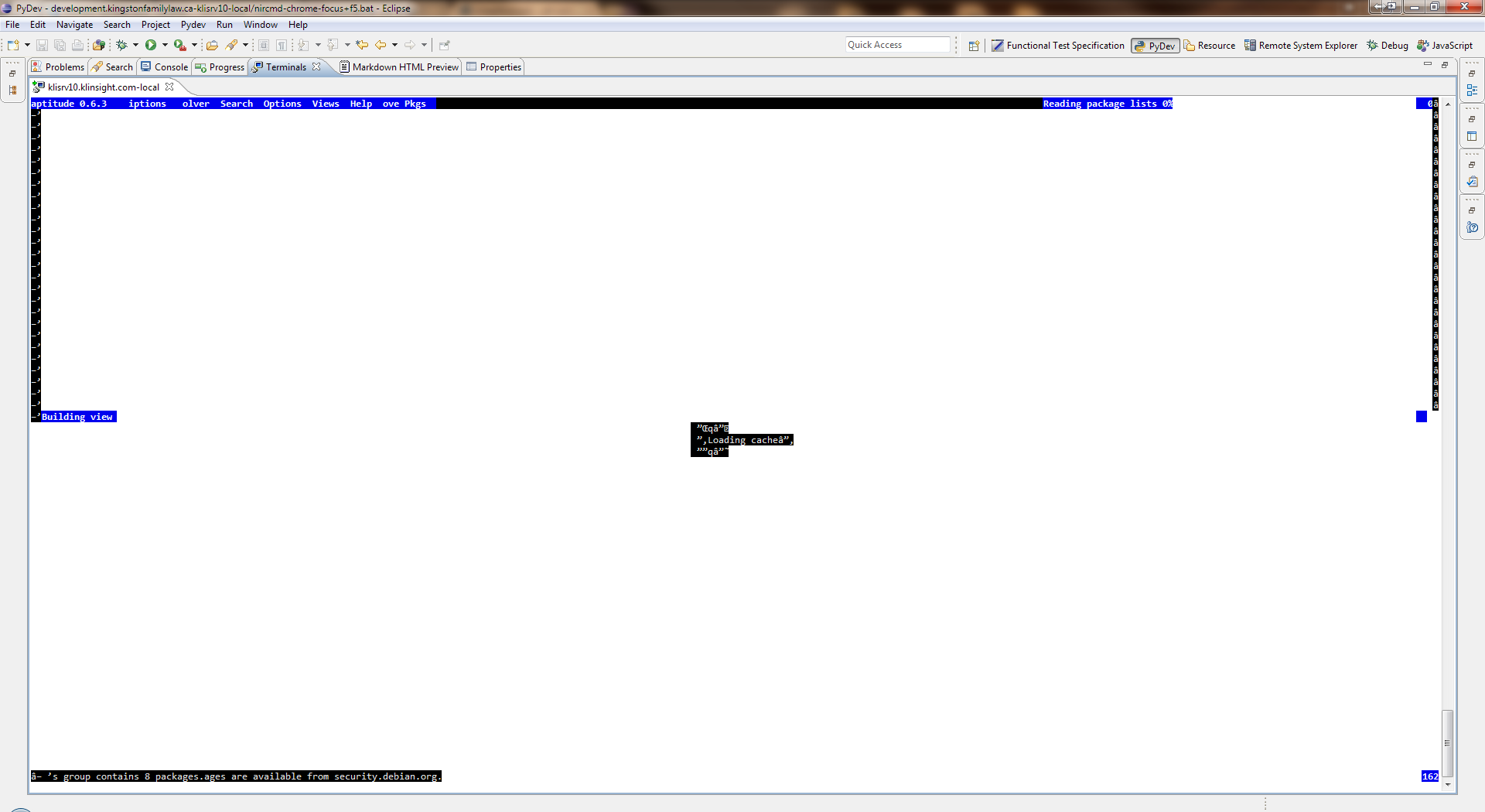

BUMP to bring this thread back to life.
Still having an issue with the rendering being broken. To duplicate lunch terminal for a remote Linux machine and simply execute 'aptitude'.
Version: Luna SR1 (4.4.1)
Build id: M20140925-0400
Target Management Terminal 3.3.300.201406060905 org.eclipse.tm.terminal.sdk.feature.group Eclipse TM Project
