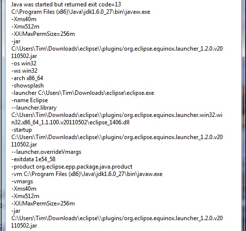

Rather than bugging everyone with a bunch of rhetoric, I'll just post screen shots of the error message, original eclipse.ini file, and eclipse.ini after my attempt at modifying it...
modified eclipse.ini file reads as follows
-startup
plugins/org.eclipse.equinox.launcher_1.2.0.v20110502.jar
--launcher.library
plugins/org.eclipse.equinox.launcher.win32.win32.x86_64_1.1.100.v20110502
-product
org.eclipse.epp.package.java.product
--launcher.defaultAction
openFile
--launcher.XXMaxPermSize
256M
-showsplash
org.eclipse.platform
256m
-vm
C:\Program Files (x86)\Java\jdk1.6.0_27\bin\javaw.exe
-vmargs
-Xms40m
-Xmx512m
the original
-startup
--launcher.library
-product
openFile
256M
-showsplash
256m
openFile
-vmargs
-Dosgi.requiredJavaVersion=1.5
-Xms40m
-Xmx384m
and the error message
index.php/fa/6107/0/
I've tried tinkering with the code a little (including/excluding certain things) but nothing seems to be working. Any ideas?

You are trying to run a 64 bit Eclipse on a 32 bit JVM. This won't
work. You need to either install a 64 bit JVM or install a 32 bit Eclipse.
