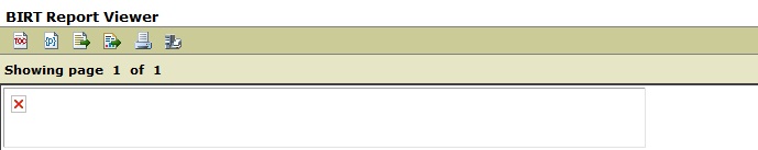

I am configuring a proxypass from DMZ to my Birt server. It is working otherwise fine, but I am missing all the images included in project. Images like navication pics that are in the viewer are loading fine. Also I am able to export the report with the images.

This is how the report loads

If you use the /preview servlet mapping instead of the /frameset mapping
do the images come through?
Jason

Re: Birt Missing images on ProxyPass [message #756536 is a reply to message #756228] Mon, 14 November 2011 04:06 Go to previous messageGo to next message
Jason Weathersby wrote on Fri, 11 November 2011 10:14
Jason
Yes on preview the images load fine.
Re: Birt Missing images on ProxyPass [message #756663 is a reply to message #756536] Mon, 14 November 2011 10:39 Go to previous messageGo to next message
Are you setting the base_url in the viewer properties?
Have a look at these:
https://bugs.eclipse.org/bugs/show_bug.cgi?id=303453
https://bugs.eclipse.org/bugs/show_bug.cgi?id=266346
Jason

Re: Birt Missing images on ProxyPass [message #756809 is a reply to message #756663] Tue, 15 November 2011 03:50 Go to previous message
Jason Weathersby wrote on Mon, 14 November 2011 10:39
Jason
I haven't set base_url.
Joseph 2010-05-25 07:54:07 EDT on Bug 303453
There is no know way to configure BIRT so that it will work BOTH when access
directly and when accessed behind a reverse proxy.
Direct access is more important for me. Actually I can settle with the preview and pdf-format reports on DMZ-access. Maybe later setup another instance of Birt and configure it working properly from proxypass.
