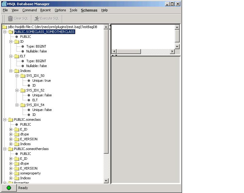

Re: Can someone provide an example of using the @IdBag annotation in Elver... [message #85089 is a reply to message #84919] Fri, 25 May 2007 14:34 Go to previous messageGo to next message
Hi Mike,
The mapping looks fine afaics. How many (and which) columns does the someclass_someotherclass table
have?
gr. Martin

The attached image indicates that there are only 2 generated, ID and ELT.
That seems right - why does the Teneo commit fail?
-mike

  • Attachment: testbagdb.JPG
    (Size: 55.82KB, Downloaded 237 times)
Re: Can someone provide an example of using the @IdBag annotation in Elver... [message #85121 is a reply to message #85104] Fri, 25 May 2007 17:33 Go to previous messageGo to next message
There should be three, two for the joins to both tables (parent and child) (id and elt) and one for
the id of the idbag entry itself (ID). My guess is that there is a nameclash between the id fields.
Although one is lowercase (id) and the other uppercase (ID) hsqldb does not seem to make a difference.
I encountered the same thing in a customer project I am doing right now. I have added an option to
set the name of the idbag id element and this solved the issue for me.
However, it will take a few weeks before I do a new release with this solution.
gr. Martin
> -mike
> "Martin Taal" <mtaal@elver.org> wrote in message
> news:f37a8j$38d$2@build.eclipse.org...
>> Hi Mike,

>>> Hi Martin,
>>> Sorry it was not clear from my first email but setting the @IdBag
>>> annotation does not work.
>>> Simply add the @IdBag annotation to the example I sent in the beginning.
>>> The
>>> mapping generated is:
>>> <idbag name="refs" table="someclass_someotherclass" lazy="true"

Re: Can someone provide an example of using the @IdBag annotation in Elver... [message #85442 is a reply to message #85121] Fri, 01 June 2007 07:46 Go to previous messageGo to next message
Hi Martin,
Did you file a bug for this issue below. I am interested in this fix (for
the 0.7.5 releases) and want to track it so I know which version of Teneo it
is supported in.
-mike
> news:f37kn7$71f$1@build.eclipse.org...
>> (id and elt) and one for the id of the idbag entry itself (ID). My guess
>> is that there is a nameclash between the id fields. Although one is
>> difference.
>> have added an option to set the name of the idbag id element and this
>> solution.
>> gr. Martin
>>> -mike
>>>> Hi Mike,
>>>> have?
>>>> gr. Martin
>>>> ELT.
>>>> -mike

Re: Can someone provide an example of using the @IdBag annotation in Elver... [message #606791 is a reply to message #84858] Fri, 25 May 2007 10:26 Go to previous message
Hi Martin,
Simply add the @IdBag annotation to the example I sent in the beginning. The
cascade="all,delete-orphan">
<collection-id column="ID" type="long">
<generator class="increment"/>
</collection-id>
<key/>
<many-to-many entity-name="SomeOtherClass" unique="false"/>
</idbag>
This does not look right but any attempt to set something does not work. Is
there an @IdBag test suite I can look at?
And the exception thrown is:
May 25, 2007 10:13:17 AM org.apache.commons.logging.impl.SLF4JLog trace
FINE: executing flush
FINE: registering flush begin
May 25, 2007 10:13:17 AM org.apache.commons.logging.impl.SLF4JLog debug
FINE: Inserting collection: [SomeClass.refs#1]
FINE: fetching initial value: select max(ID) from someclass_someotherclass
FINE: about to open PreparedStatement (open PreparedStatements: 0, globally:
0)
FINE: select max(ID) from someclass_someotherclass
FINE: preparing statement
FINE: first free id: 1
FINE: about to close PreparedStatement (open PreparedStatements: 1,
globally: 1)
FINE: closing statement
May 25, 2007 10:13:18 AM org.apache.commons.logging.impl.SLF4JLog debug
0)
FINE: insert into someclass_someotherclass (id, ID, elt) values (?, ?, ?)
May 25, 2007 10:13:18 AM org.apache.commons.logging.impl.SLF4JLog trace
FINE: could not insert collection: [SomeClass.refs#1] [insert into
someclass_someotherclass (id, ID, elt) values (?, ?, ?)]
java.sql.SQLException: Column count does not match in statement [insert into

Re: Can someone provide an example of using the @IdBag annotation in Elver... [message #606802 is a reply to message #84919] Fri, 25 May 2007 14:34 Go to previous message
Hi Mike,
have?
gr. Martin
    (Size: 55.82KB, Downloaded 208 times)
Re: Can someone provide an example of using the @IdBag annotation in Elver... [message #606804 is a reply to message #85104] Fri, 25 May 2007 17:33 Go to previous message
gr. Martin
>> -mike
>>> Hi Mike,
>>> have?
>>> gr. Martin
>> difference.
>> solution.
>> gr. Martin
>>> child) (id and elt) and one for the id of the idbag entry itself (ID).
>>> My guess is that there is a nameclash between the id fields. Although
>>> I have added an option to set the name of the idbag id element and this
>>> solution.
>>> gr. Martin
>>>> ELT.
>>>> -mike
