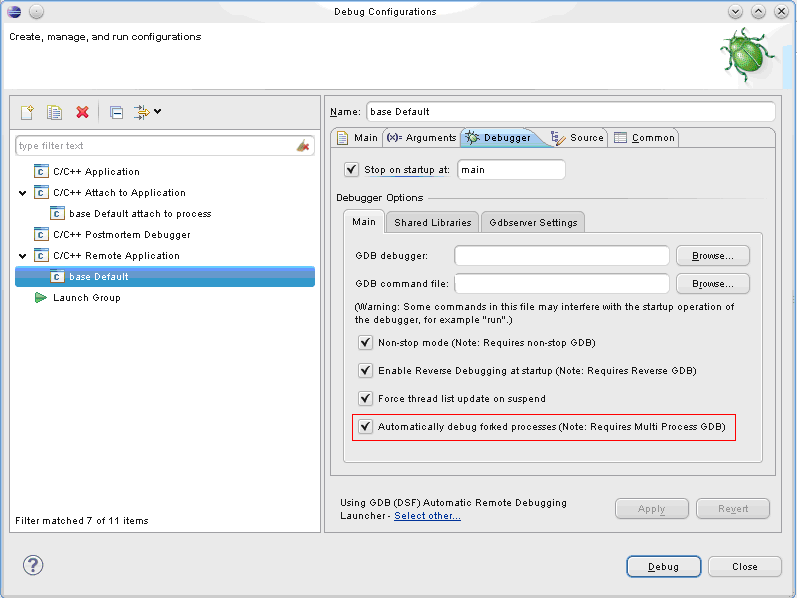

Re: C/C++ Remote Application and multiprocess debugging [message #749974 is a reply to message #749959] Tue, 25 October 2011 10:55 Go to previous messageGo to next message
Ok, thanks to start the gdbserver at startup, could be a solution. I will try this.
However, why is in the "C/C++ Remote Application" the option "automatically debug forked process" available?
index.php/fa/4523/0/
In my test only the parent process is attached - is this perhaps a bug?
Mark
[Updated on: Tue, 25 October 2011 10:56] by Moderator
Re: C/C++ Remote Application and multiprocess debugging [message #749986 is a reply to message #749974] Tue, 25 October 2011 11:05 Go to previous messageGo to next message
To be honest, the options are always nicely filtered based on the current launch.
I'm not sure if this option works or not in the Remote Application launch.
If you believe it shouldn't be there in that case, you can write a bug (bugs.eclipse.org)
to hopefully get that cleaned-up
Marc
