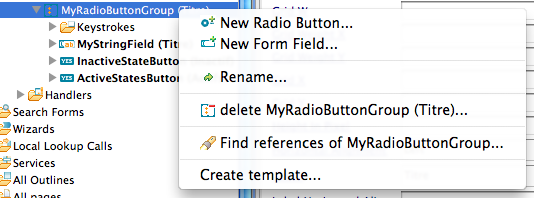

3. RadioButtonGroup and CompositeField
For RadioButtonGroup, the situation is a little bit different. The SDK allows to add RadioButton or any kind of FormField.
index.php/fa/4304/0/
The FormFields (for example a StringField) added in the RadioButtonGroup also appears...
I personally wonder what the use case is, to have any kind of FormField as inner-class of a RadioButtonGroup... For me only inner RadioButtons makes sense.

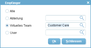

A very often case is having a "list" of sections where a radio button is on the left and a group box or other field is on the right. That can that way easily be covered.
The following example is in place in some projects (simplified code):
public class RadioButtonGroup extends AbstractRadioButtonGroup<Long> {
  public class EveryoneButton extends AbstractRadioButton {
  public class EveryoneField extends AbstractPlaceholderField {
  public class PartitionButton extends AbstractRadioButton {
  public class PartitionField extends AbstractSmartField<Long> {
  public class DepartmentButton extends AbstractRadioButton {
  public class DepartmentField extends AbstractSmartField<Long> {
  public class TeamButton extends AbstractRadioButton {
  public class TeamField extends AbstractSmartField<Long> {
  public class PersonButton extends AbstractRadioButton {
  public class PersonField extends AbstractPersonField {
And this looks as the attached image.
