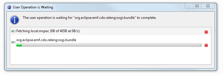

I've tried it again. Same result, the following modal dialog does
not progress in any way:<br>
<br>
<img src="http://www.eclipse.org/forums/index.php?t=getfile&amp;id=4305" alt=""><br>
<br>
The folder where the clone is supposed to appear gets created and
filled with 3 files and 11 subfolders but the total size stays at
248 bytes.<br>
<br>
No progress is reported, no timeout error, no any error.<br>

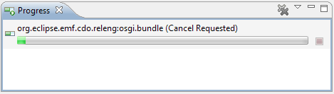

I can cancel the jobs in the progress dialog and ancel the import
wizard, but it seems some job is not really dead thereafter:<br>
<br>
<img src="http://www.eclipse.org/forums/index.php?t=getfile&amp;id=4306" alt=""><br>
<br>
Only a restart of the IDE helps then.<br>
