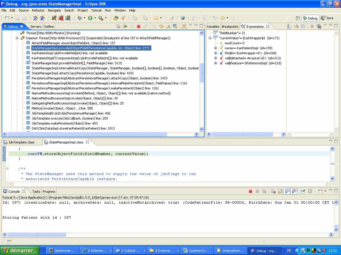

Data access failure: Could not invoke JDO makePersistent(Object) method;
nested exception is java.lang.ClassCastException:
org.eclipse.emf.teneo.jpox.elist.EListWrapper$1
org.springframework.dao.InvalidDataAccessResourceUsageExcept ion: Could not
invoke JDO makePersistent(Object) method; nested exception is
org.eclipse.emf.teneo.jpox.elist.EListWrapper$1 at
org.eclipse.emf.teneo.jpox.elist.EListWrapper.attachCopy(ELi stWrapper.java:431)
at
org.jpox.state.AttachFieldManager.storeObjectField(AttachFie ldManager.java:157)
at
org.jpox.state.StateManagerImpl.providedObjectField(StateMan agerImpl.java:2748)
at org.MyClassImpl.jdoProvideField(MyClassImpl.java) at....

and the eclipse debugger seems to say that there is a nullPointerException
in the EListWrapper attachCopy method execution :
public class EListWrapper<E> extends PersistableEList<E> implements SCO,
Queryable, SCOList {
public void attachCopy(Object value) {
// if not loaded then nothing changed so nothing to attach
assert (value instanceof PersistableEList);
if (!((PersistableEList) value).isLoaded())
return;
because "binding error on value"... which is null ("binding ==null for
value")

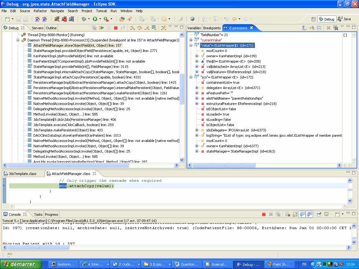

but the call, from the org.jpox.state.StateManager to the teneo sco class
(ElistWapper) seems to be good
public class AttachFieldManager extends AbstractFieldManager
public void storeObjectField(int fieldNumber, Object value)
sco.attachCopy(value);
sco and value are ElistWapper$1, empty but not null

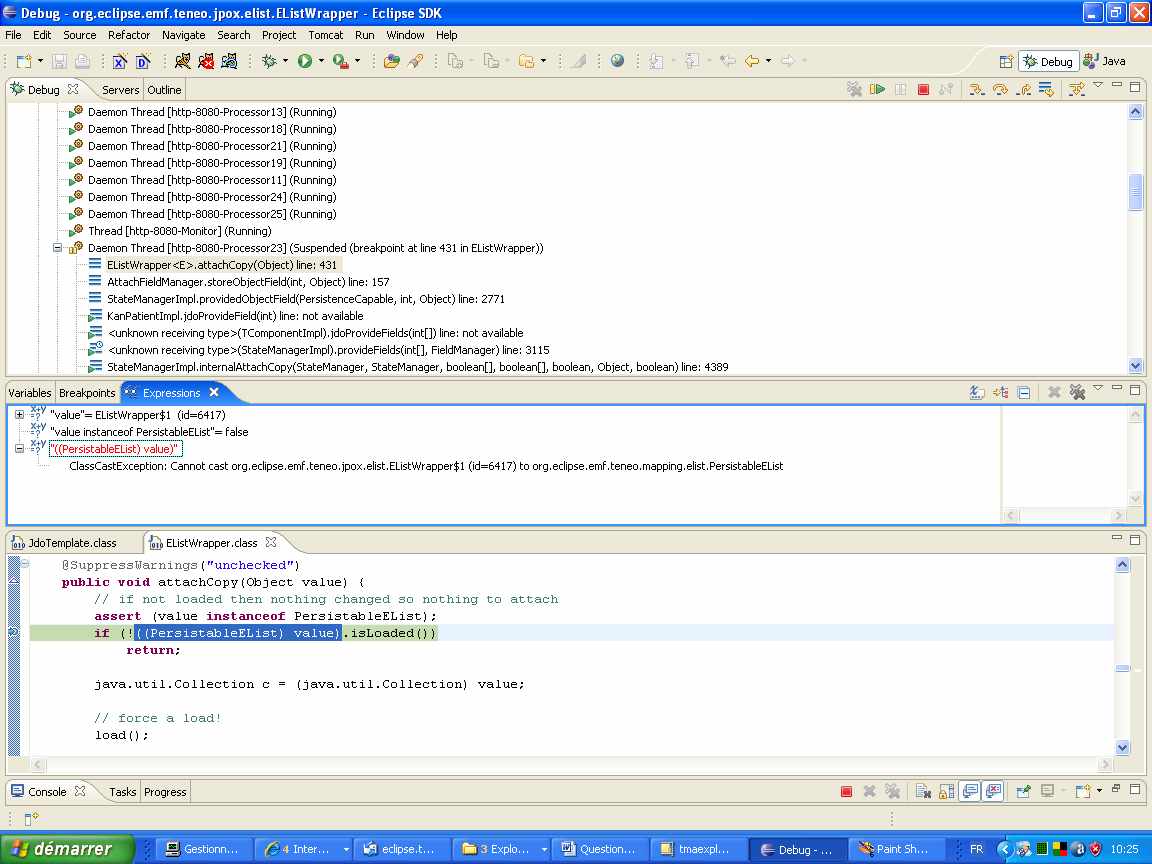

a nullPointerException occur in the EListWrapper attachCopy method =
execution, (=3D=3D> called by the "makePersistentMethod.invoke" )
and the line 431 is "if (!((PersistableEList) value).isLoaded())"=20
public class EListWrapper<E> extends PersistableEList<E> implements SCO, =
line430 >> assert (value instanceof PersistableEList);
line431 >> if (!((PersistableEList) value).isLoaded())=20
return;
upgrade to jpox 1.1.7? I've read somewhere in Jpox forum that "above =
Jpox 113 only Spring 2 is compatible and I didn't want to change my jsp =
code for the spring 2 forms syntax...
but, I just try with jpox117 and...=20
1- it doesn't seem to make problems with spring forms syntax, at first =
look...
2- error messages from the eclipse debugger is a bit clearer :
for line 430 execution : >> value instanceof PersistableEList"=3D false=20
for line 431 execution : >> ClassCastException: Cannot cast =
org.eclipse.emf.teneo.jpox.elist.EListWrapper$1 (id=3D217) to =
org.eclipse.emf.teneo.mapping.elist.PersistableEList=20
gr. Daniel

>> and the eclipse debugger seems to say that there is a =
nullPointerException=20
>> public class EListWrapper<E> extends PersistableEList<E> implements =
SCO,=20
>> return;
=3D=3Dnull for=20
>> value")
>>=20
>> but the call, from the org.jpox.state.StateManager to the teneo sco =
class=20
>>=20
>> the teneo log seems to be good :

<DIV><FONT face=3DArial size=3D2>but the call within this try (1) =
("return=20
makePersistentMethod.invoke(pm, new Object[] {entity});") fails =
because...=20
according to the Eclipse debugger,&nbsp; </FONT></DIV>
<DIV><FONT face=3DArial size=3D2>a nullPointerException occur in the =
EListWrapper=20
attachCopy method execution, (=3D=3D&gt; called by=20
the&nbsp;"makePersistentMethod.invoke"&nbsp;)</FONT ></DIV>
<DIV><FONT face=3DArial size=3D2></FONT>&nbsp;</DIV>
<DIV><FONT face=3DArial size=3D2>and the line 431 is "if =
(!((PersistableEList)=20
value).isLoaded())"&nbsp;</FONT></DIV>
<DIV><FONT face=3DArial size=3D2>public class EListWrapper&lt;E&gt; =
extends=20
PersistableEList&lt;E&gt; implements SCO, Queryable, SCOList =
{</FONT></DIV>
<DIV><FONT face=3DArial size=3D2>....</FONT></DIV>
<DIV><FONT face=3DArial size=3D2>public void attachCopy(Object value) =
{</FONT></DIV>
<DIV><FONT face=3DArial size=3D2>// if not loaded then nothing changed =
so nothing to=20
attach</FONT></DIV>
<DIV><FONT face=3DArial size=3D2>line430 &gt;&gt; assert (value =
instanceof=20
PersistableEList);</FONT></DIV>
<DIV><FONT face=3DArial size=3D2>line431 &gt;&gt;&nbsp;if =
value).isLoaded()) </FONT></DIV>
<DIV><FONT face=3DArial size=3D2>return;</FONT></DIV>
<P><FONT face=3DArial size=3D2>upgrade to jpox 1.1.7? I've read =
somewhere in Jpox=20
forum that "above Jpox 113 only Spring 2 is compatible and I didn't want =
to=20
change my jsp code&nbsp;for the&nbsp;spring 2 forms syntax...</FONT></P>
<P><FONT face=3DArial size=3D2>but, I just try with jpox117 and... =
</FONT></P>
<DIV><FONT face=3DArial size=3D2>1- it doesn't seem to make problems =
with spring=20
forms syntax, at first look...</FONT></DIV>
<DIV><FONT face=3DArial size=3D2>2- error messages from the eclipse =
debugger is a=20
bit clearer :</FONT></DIV>
<DIV><FONT face=3DArial size=3D2>for line 430 execution : &gt;&gt; <FONT =
color=3D#ff0000><STRONG>value instanceof PersistableEList"=3D=20
false</STRONG></FONT>&nbsp;</FONT></DIV>
<DIV><FONT face=3DArial size=3D2>for line 431 execution : &gt;&gt; <FONT =
color=3D#ff0000><STRONG>ClassCastException: Cannot cast=20
org.eclipse.emf.teneo.jpox.elist.EListWrapper$1 (id=3D217) to=20
org.eclipse.emf.teneo.mapping.elist.PersistableEList</STRONG ></FONT>&nbsp=
;<BR></FONT></DIV>

Re: ClassCastExeption with Elistwrapper [message #79993 is a reply to message #79960] Tue, 17 April 2007 04:59 Go to previous messageGo to next message
Originally posted by: daniel.bret.w.wanadoo.fr
Hi Martin
> Was the instance (EListWrapper$1) created before in a call to detachcopy?
the instance (EListWrapper$1) seems to be created in the
KanPatientImpl.jdoProvideField(int) method execution (uneasy because jdo
method are not accessible by debugger) (see jpg debug_01)
after that, the call to EListWrapper seems to be good, with real instance
(not null) (see jpg debug_02)
ant finaly, in the EListWrapper.attachCopy(object) :
1- the "assert (value instanceof PersistableEList);" should send an
exception whereas "value instanceof PersistableEList"= false, shouldn't it ?
2- why value instanceof PersistableEList"= false and why the value
(EListWrapper$1 (id=xxx) cannot be cast to PersistableEList if EListWrapper
is a subclass of PersistableEList (public class EListWrapper<E> extends
PersistableEList<E>.) ? (see jpg debug_03)
I can report that on Eclipse bugzilla EMFT, if you like
gr. Daniel

Re: ClassCastExeption with Elistwrapper [message #80024 is a reply to message #79993] Tue, 17 April 2007 09:52 Go to previous message
Hi Daniel,
Afaik the EListWrapper$1 is not the EListWrapper itself but an anonymous inner class. My guess is
that this one is created in the detachCopy method (you can try by setting a breakpoint there). So
the attachcopy method check on PersistableEList should also check if the type is a PersistableEList
and only check isloaded in that case and allow other cases to pass on.
Can you enter a bugzilla for this?
gr. Martin
>>> look...
>>> for line 430 execution : >> *value instanceof PersistableEList"= false*
>>> for line 431 execution : >> *ClassCastException: Cannot cast
>>> org.eclipse.emf.teneo.jpox.elist.EListWrapper$1 (id=217) to
>>> org.eclipse.emf.teneo.mapping.elist.PersistableEList*
>>> gr. Daniel

but the call within this try (1) ("return =
because... according to the Eclipse debugger, =20
return;
look...
gr. Daniel
SCO,=20
>> return;
=3D=3Dnull for=20
>> value")
>>=20
class=20
>>=20
("return=20
because...=20
EListWrapper=20
extends=20
{</FONT></DIV>
{</FONT></DIV>
so nothing to=20
attach</FONT></DIV>
instanceof=20
to=20
</FONT></P>
with spring=20
debugger is a=20
;<BR></FONT></DIV>
>>> look...
>>> gr. Daniel
>>> SCO,
>>> >> return;
>>> for
>>> >> value")
>>> class
>>> >> 15:53:55,625 (http-8080-Processor23) DEBUG
>>> >> [org.eclipse.emf.teneo.mapping.elist.PersistableEList] - Loading
>>> EList of
>>> >> type: org.eclipse.emf.teneo.jpox.elist.EListWrapper of member
>>> myField (that
>>> >> cause the error) owned by MyClass with delegate list
>>> java.util.ArrayList
>>> >> I use Eclipse3.2, EMF 2.2.2, teneo : emft-teneo-SDK-I200703301643,
>>> Jpox1.3
>>> >> (to stay compatible withe Spring 1.2.X for syntax reason), Spring
>>> 1.2.8.
>>> >> I've tried with Eclipse3.3, EMF 2.3, teneo :
>>> >> etc... and that's the same
>>> >> To be able to send you an example to reproduce to problem, I'tried
>>> to shrink
>>> >> my webapp to the 3 or 4 classes with the field which cause the
>>> error... but
>>> >> in this case, I have no error...?
>>> >> I don't know where to search the error
>>> >> Thanks
